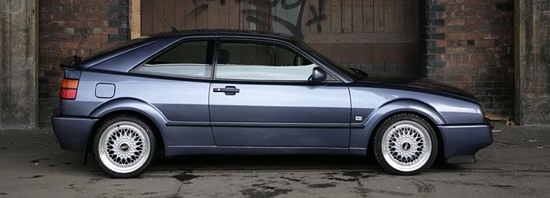

VR6*MarkOfTheBeast* 0 Posted May 14, 2007 i'm getting sick of cr**ping myself whenever i come accros speed bumps/multistorys etc. i'm going to fit a smaller front splitter/remove the cat. this should stop the scraping but leaves the sump all on it's own down there. is there any way i can protect it? Quote Share this post Link to post Share on other sites
Goldie 2 Posted May 14, 2007 How low is you car?? I catch the splitter but thats all (touch wood)... Quote Share this post Link to post Share on other sites
VR6*MarkOfTheBeast* 0 Posted May 14, 2007 Not THAT low? i've seen lower. Quote Share this post Link to post Share on other sites
Goldie 2 Posted May 14, 2007 You on adjustables?? If so id lower the back more, itll bring the nose up a little if you do.. Either that or id be avoiding multi storeys.. Looks lovely by the way.. Quote Share this post Link to post Share on other sites
herisites 0 Posted May 14, 2007 As goldie said mate if on adjustables deffo lower the rear a bit if your arches/wheels allow as this gives that bit more clearance on the front which doesnt look a lot visibly but somehow makes hell of a difference :lol: Otherwise a mate of mine has a mk2 sump guard i believe, not sure if it needs modding or anything but he couldnt find a vr6 one. His names Bendy on here so might be worth dropping him a PM. Quote Share this post Link to post Share on other sites
VR6*MarkOfTheBeast* 0 Posted May 14, 2007 thanks. dubsport put the coilovers on two weeks ago and the photo's were taken soon after so it still had'nt settled. the back has come down a bit more since but i'l have a look and maybe give it another cheeky drop at the back. cheers! Quote Share this post Link to post Share on other sites
Bendy 0 Posted May 15, 2007 hello someone called me!! :lol: as rob was sayin i do have a mk2 golf sump guard on mine, not a straight fit. the front bolts on and the rear is attached to the arb and something above it i think!! :oops: cant remember what it is attached to but ive not had any trouble with it falling off so all's good!! stopped me smashing more sumps so def worth it for piece of mind. cheers ben Quote Share this post Link to post Share on other sites
