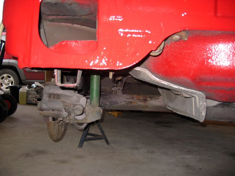

Wasn't long after getting it home before I got stuck in and first thing being getting it up on the axle stands...
then off with the steelies...
