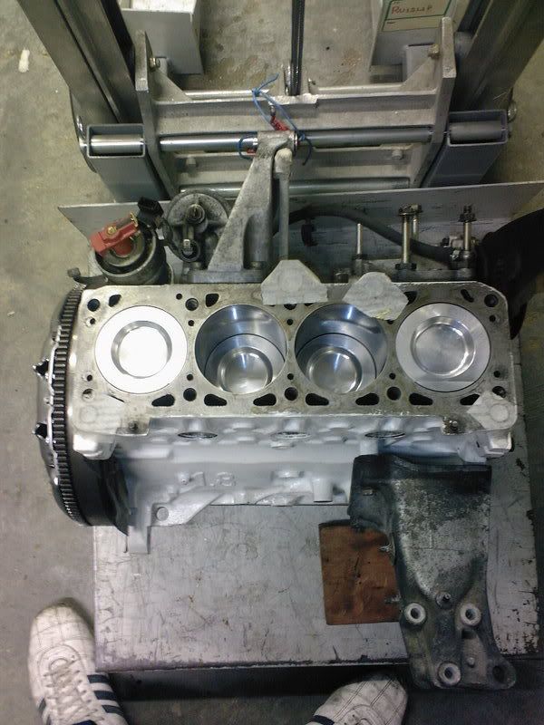

Dubsingh 0 Posted July 21, 2007 hi all i have just 80% completed my engine rebuild, just gona pop the old stem seals out and put the new ones in, as i checked my head and its not warpped so id rather not get it skmmed after reading a few other threads which say not to do it unless really needed. cleaned the face using a super flat block with fine grade emery to clean any muck off. right there are a few questions that i have, as the car has been sitin still for over a month now witht he bat disconected will there be any funky procedure i need to follow when all is connected up again? is the timing as simple as the gti valver? or is there a special procedure for the g60 any hints and tips will be greatly apreciated., surely after i get the head connected i wil have some wiring questions as i think iv forgoten where some go...but ill ask as i encounter them pics of rebuild to follow Quote Share this post Link to post Share on other sites

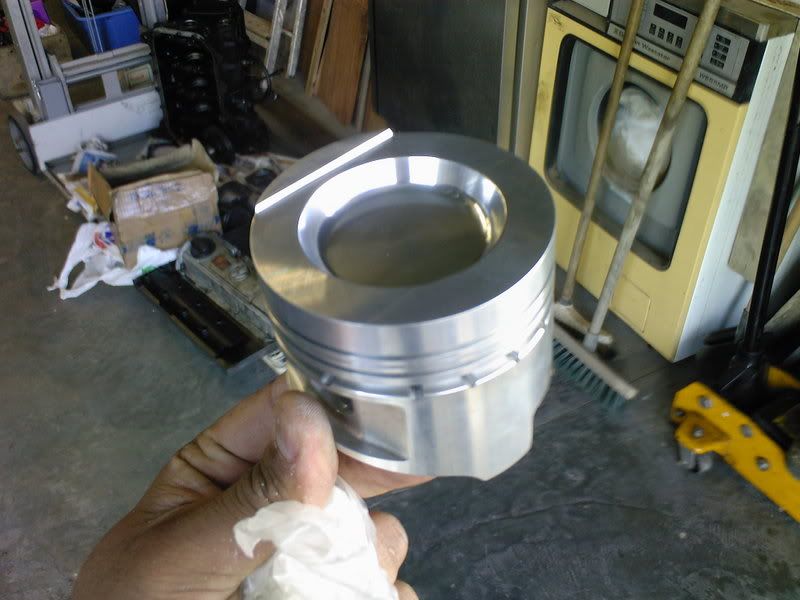

Dubsingh 0 Posted July 21, 2007 my new pistons and yes i knw i been sniffin sumin white engine block lol Quote Share this post Link to post Share on other sites

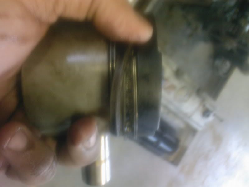

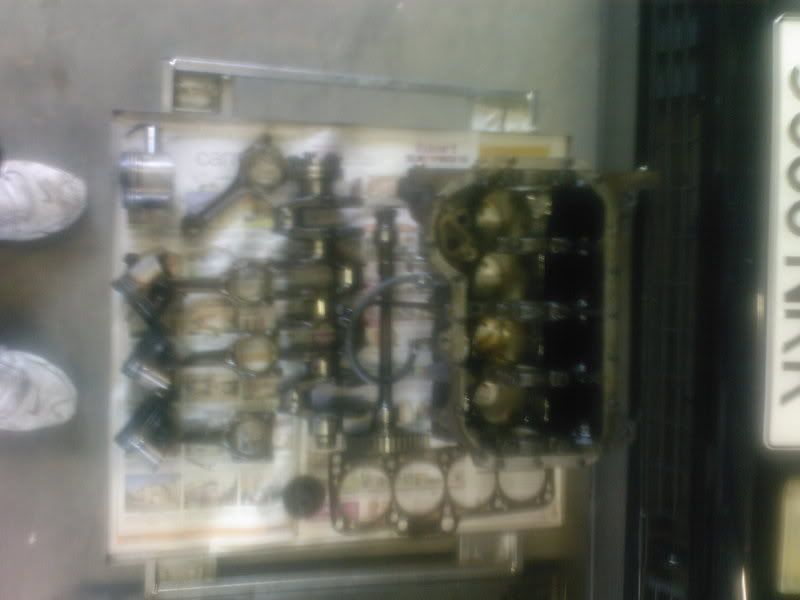

Dubsingh 0 Posted July 21, 2007 some reverse order pic thread here i knw sorry..here are the old bits out from the block and the state of the piston shos what the other three were like too..... messed up pistons (no wonder i only had around 60 - 105 on the compression test) the new custom pistons that i got from philT of this fourn man was a life saver...and helped my pocket a bit absolute bargain... shall have pics of the engine and box bolted into the car tomo just gota pick up the nerve to do the head now thng is i speand more time cleanin that i get carried away....guys again if there are any pitfalls that i should be aware of when i have her bolted up and ready to fire for the first time plz feel free to advice me many thanks in advance Quote Share this post Link to post Share on other sites

g60bv 0 Posted July 22, 2007 ive just had the same thing done to mine. still running it in. my piston did the same . a small slice fell out between the rings. odd ah. did you get the crank rebalanced.might be worth it.. Quote Share this post Link to post Share on other sites
Dubsingh 0 Posted July 22, 2007 yup balanced along with the fly wheel with a little lightning not to much. the pistons get lie that if the car has overheated. i knw the guy i bought it from overheated it as the bills showed new water pump thermo stat, tempratre sensors etc etc Quote Share this post Link to post Share on other sites
