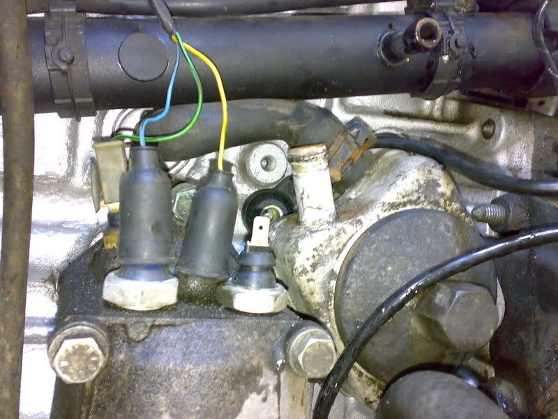

Took a few piccy's on the way to help others out if needed!
Basically, you have to remove complete front end - bumper, headlights, slam panel, etc to get to it easier. In doing this you have to drain water system of all coolant. I also removed both coolant pipes from the oil cooler to aid me getting the bolt in the sensor.
This took me about 2.5 hours to do, and only about 20 secs of that was actually fitting the sensor, lol. What a bummer - if only i'd fitted it before i put the engine in, lol! Typical!
Pic 1 :- Before i started
Pic 2 - After about 30 mins
Pic 3 - After 45 Mins - All ready to have a go at it now
Pic 4 - Close up of where the sensor goes - The little shiny surrounded Hole in the block - Just above but between the oil filet housing and the sandwich cooler! (above the oil sender on the right)
Anyway, car is now run in, and has fresh synta silver in her - new genuine pas fluid, and new genuine coolant etc and my god does it pull like a train now! That sensor really does knock the power down a bit. Economy is now much much better also, easily sits at 35mpg now, instead of struggling to hit 28, lol!
Cheers everyone for your help:-
Just one more thing though. Next to the plug for the knock sensor 2 - there is a singal wire - comes from the same loom, has a single female spade connector on it - wire is couloured yellow with black trace - Where does this go? couldnt find anywhere to plug it onto but it must go somewhere?
