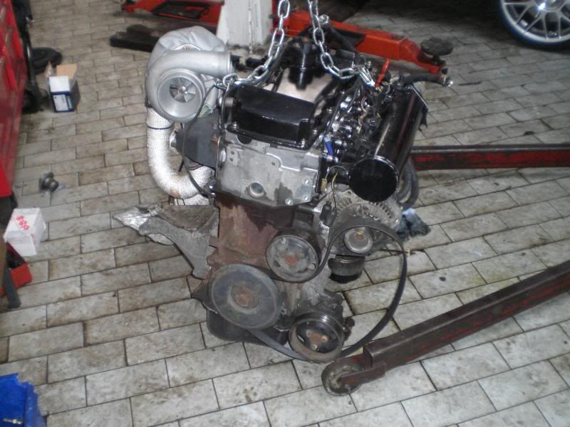

CorradoVR6-Turbo 0 Posted June 15, 2008 took the engine out yesterday,going to strip and build it during the week,should be back in for next saterday! One old engine... Share this post Link to post Share on other sites

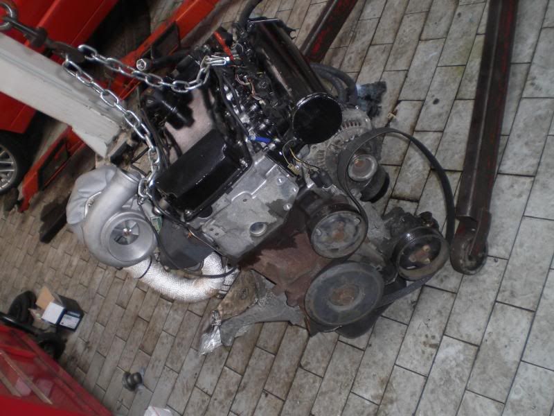

Chris VR6nos 0 Posted June 15, 2008 J, did you take the box out with the engine or just the engine it's self? I've generally taken the box out in one go 'cos always found it a real chore to try and leave the box in. Chris Share this post Link to post Share on other sites
bcstudent 0 Posted June 15, 2008 It looks like the gearbox is attached in the second pic. Share this post Link to post Share on other sites
CorradoVR6-Turbo 0 Posted June 15, 2008 bcstudent said: It looks like the gearbox is attached in the second pic. well spoted, :clap: Share this post Link to post Share on other sites
bcstudent 0 Posted June 15, 2008 Yeah...I'm sharp like that :) Share this post Link to post Share on other sites
dirtytorque 0 Posted June 15, 2008 I'm enjoying reading about your tussle with this engine. I'm sure it will be worth it in the end. Any clues as to what caused the problem? Share this post Link to post Share on other sites
CorradoVR6-Turbo 0 Posted June 15, 2008 dont know mate,the ammount of oil its spat into the inlet manifold and exhaust is quite allot,i suspect i ran lean and there will be signs of it when i pull the engine appart,then if thats the case then i will uprate my pump. but will post up pics at each stage bud :tongue: Share this post Link to post Share on other sites
