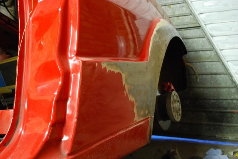

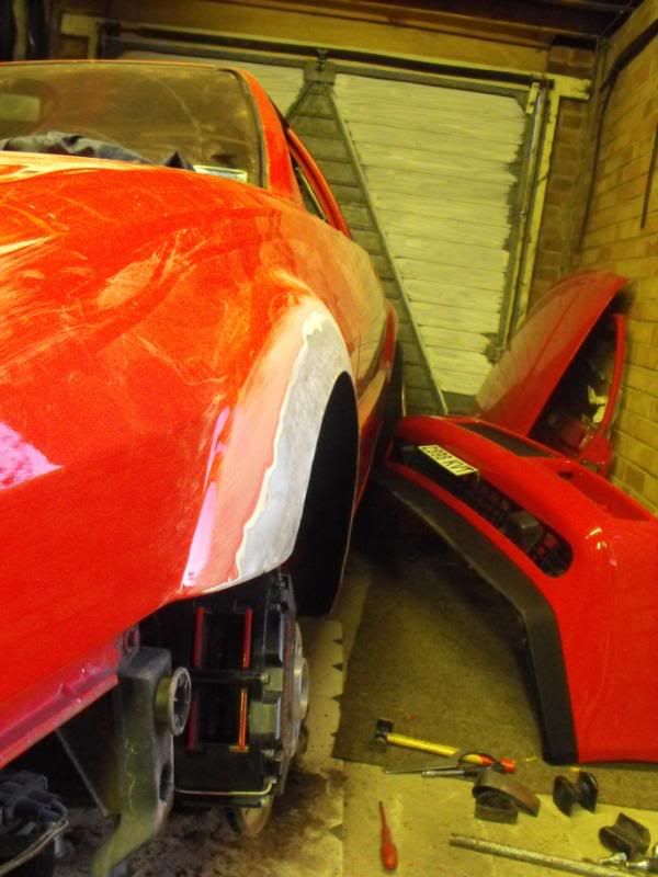

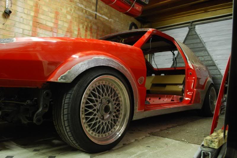

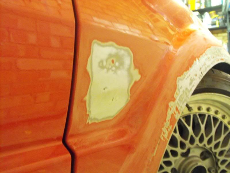

CorradoVR6-Turbo 0 Posted September 16, 2009 20vtvw said: love it ,how much extra room have you got now ?i need about 20mmdo you think this is possible?? :notworthy: Got around 1" ish now all round mate,so with some hard graft its possible !! :tongue: biggerbigben said: Nice work on the arches James.. Cheers Bud :wink: Done some more work,havent had much time,welded up the rear badge holes,finished the drivers rear arch,had a lot of work to cut and re-weld the inner tub to quater pannel,but its done now,just needs to be seam sealed and stonechiped,filled,smoothed and painted....not much then :cuckoo: :lol: Randoms... Share this post Link to post Share on other sites

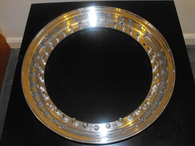

CorradoVR6-Turbo 0 Posted September 17, 2009 cheers folks :wink: decided on the centre of the wheel colour is going to be the same as the car....red,going to do one wheel to see how it works. Also spent some time polishing one of the rims and 36 bolts....still more to polish but getting there 8) Share this post Link to post Share on other sites

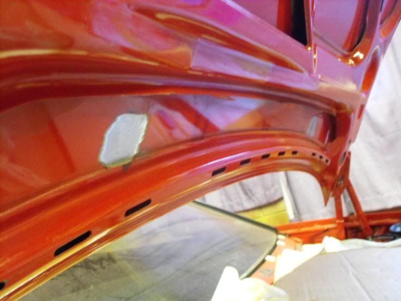

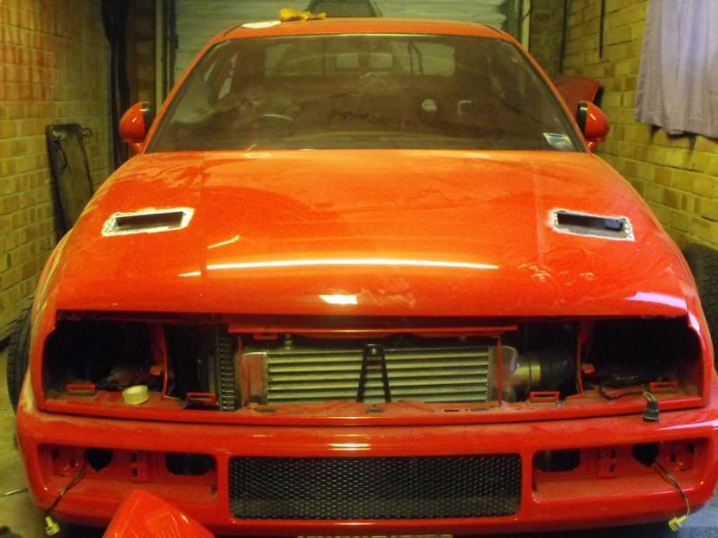

CorradoVR6-Turbo 0 Posted September 19, 2009 Got a bit still to do mate,then then the hole car needs blocking and wet sanding before paint....plenty to do not enough.. :sleeping: but early next year should be done. Got a bit more done after work today,welded up rear wiper,side repeter holes and washer jet holes. Also bined my rover metro bonnet vents for some custom scoops,still not finished yet but they are taking shape! :tongue: Share this post Link to post Share on other sites
carpoid 0 Posted September 19, 2009 Good stuff mate, i like your thinking on the bonnet vents, 8) should be pretty subtle when painted. I was thinking a couple of weeks ago if it would be possibe to do that sort of thing but using the buldge in the middle and having the full width of the buldge, would be awesome if it was subtle and looked stock. Especially on a VRT, did your others make a big difference? What turbo are you using on yours? I really want to VRT mine now, i'm on the hunt for a VR engine at the moment. Polishing those rims is hard work, i done mine by hand going down through the grades of paper, was cream crackered with one big arm by the end of it :gag: :D Share this post Link to post Share on other sites

CorradoVR6-Turbo 0 Posted September 22, 2009 carpoid said: Good stuff mate, i like your thinking on the bonnet vents, 8) should be pretty subtle when painted. I was thinking a couple of weeks ago if it would be possibe to do that sort of thing but using the buldge in the middle and having the full width of the buldge, would be awesome if it was subtle and looked stock. Especially on a VRT, did your others make a big difference? What turbo are you using on yours? I really want to VRT mine now, i'm on the hunt for a VR engine at the moment. Polishing those rims is hard work, i done mine by hand going down through the grades of paper, was cream crackered with one big arm by the end of it :gag: :D Me and you think alike! i was some time ago going to use a early bonnet with a later bonnet hump grafted on with a small entry,scoop close to the front,then open up a hole in the rear in the underside directly above the turbo! mabey one day? :tongue: They do cool the bay allot more than before so they are a good mod and down your way its essential!! The turbo is a T70 mate. :) jchn_smith said: looking good, realy liked these wheels on ashleys car but seeing them on yours with your archs and stance makes them look another level, what size tyres are you going to be running john Cheers bud,im hoping they will suit it well,once painted it should be just right :) ,sticking with 205 at the front and 215 at the rear :tongue: Done a bit more,stripped all the stone chip off the drivers sill,so once painted it will be nice and smooth,finished off tailgate and made up some bonnet vets,used the holes i made with the last set,still not sure,but once painted it should look good...i hope lol! Everything that is bare steel is painted with cure-rust,brill stuff...just to make sure nothing comes back in future years to come. Share this post Link to post Share on other sites

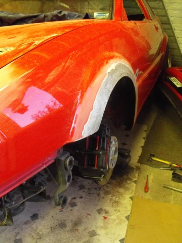

CorradoVR6-Turbo 0 Posted September 24, 2009 Back off you lot [strike:1lahz0qr]I will NEVER sell this[/strike:1lahz0qr]...sod it ive been there before :lol: Done some more tonight,beat out the passanger arch,took allot less time than the other side due to practice,got a much cleaner shape in no time im well pleased :D Rear arch next! :help: Share this post Link to post Share on other sites

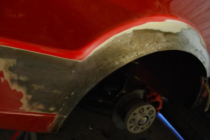

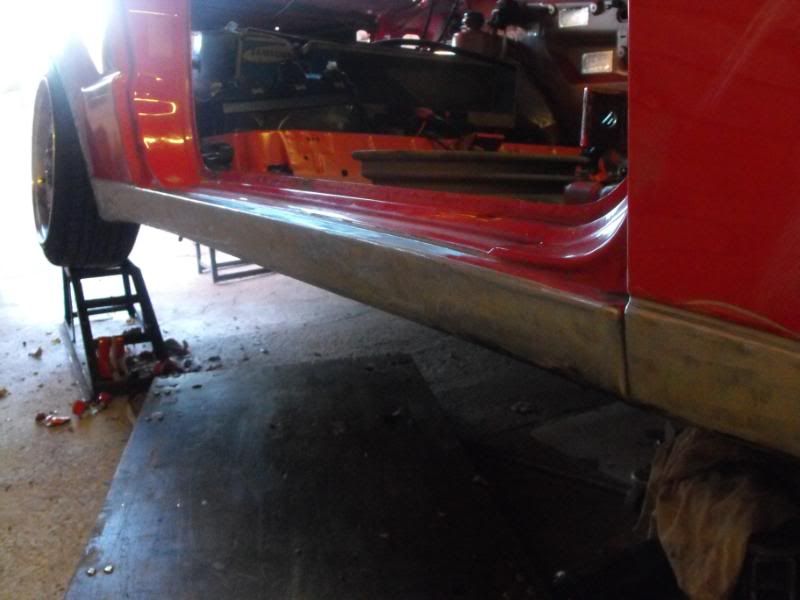

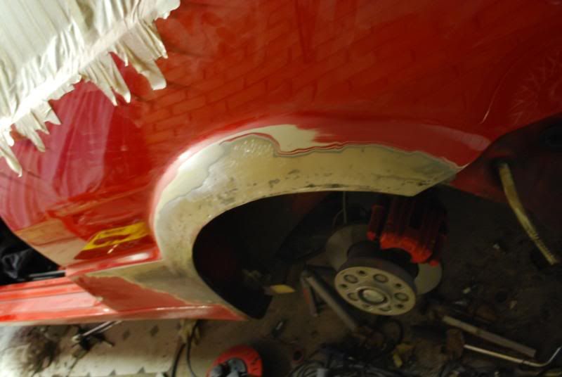

CorradoVR6-Turbo 0 Posted October 25, 2009 well done some more,car is ready for bodyshop now but wether has been poop to move it :bad-words: During my last update ive finished the passanger rear arch which needed allot of work due to previous damage,all sorted now,striped the passanger sill of underseal,bought a carbon bonnet that needed some work to bring back up to standard and also weleded up any unessary holes in the slam pannel which took ages to do but will be worth it once in paint :D Randoms. next update from the bodyshop :clap: Share this post Link to post Share on other sites
KipVR 1 Posted October 25, 2009 Nice work 8) Bodywork updates are always good fun to follow, can't wait to see it finished! How does your oil cooler get air through it? Isn't it behind the bumper? Share this post Link to post Share on other sites
CorradoVR6-Turbo 0 Posted October 25, 2009 Thanks kip,the oil cooler and intercooler are cooled with the large opening in the front bumper :tongue: Share this post Link to post Share on other sites

aide 0 Posted October 25, 2009 looking really good, cant wait to see how arches turn out what do you call those curved lumpy metal things your using? could an amateur have a fair crack at doing this ? :grin: Share this post Link to post Share on other sites
CorradoVR6-Turbo 0 Posted October 25, 2009 I would not recommended this if you are not handy with fabrication,it takes allot of time,and the shaped metal is a hammer and dolly set,commonly used in bodyshops,its a cheap set as im doing it once only!! :tongue: Share this post Link to post Share on other sites
