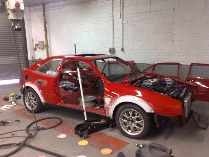

CorradoVR6-Turbo 0 Posted November 15, 2009 ToffeeRado said: Gotta love the Flash Reds :) Nice work Cheers Bud :tongue: In bodyshop now......its getting there :clap: Share this post Link to post Share on other sites

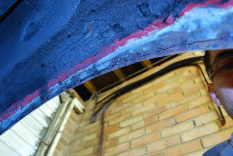

PiercedWinky 0 Posted November 28, 2009 Well done archwork. Any more pics of the rears? Share this post Link to post Share on other sites

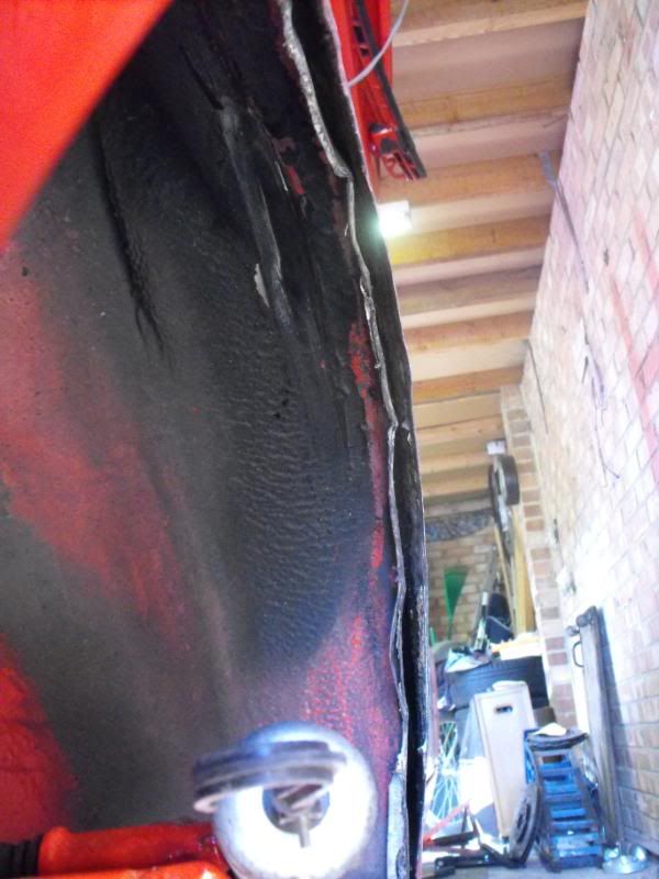

CorradoVR6-Turbo 0 Posted November 29, 2009 Thanks for all the replys folks,its going to be worth all the hassle once its in paint and back together,cant wait as im sick on my daily snail.. :brickwall: PiercedWinky said: Well done archwork. Any more pics of the rears? I have never done bodywork before so i cant say if its right or wrong,but as you know the fronts fenders are easy as you can get to the back of them,but the rears i had to separate the inner tub from the arch so i could get to the back of them,took some time to do and it gives me plenty of room for tyre sizes and no running. Look away no if you have a nervous disposition! :lol: Separated then pulled allot more back than i have in this photo! Once i had the shape i beat the inner tub back to shape and welded it tight then its for seam sealer,underseal etc. Thne you have.... Share this post Link to post Share on other sites

PiercedWinky 0 Posted November 30, 2009 CorradoVR6-Turbo said: I have never done bodywork before so i cant say if its right or wrong,but as you know the fronts fenders are easy as you can get to the back of them,but the rears i had to separate the inner tub from the arch so i could get to the back of them,took some time to do and it gives me plenty of room for tyre sizes and no running. You did just fine on the rears. When I was helping Russ with his that is exactly how we did the rears of his car. Although with mine since it will be a much more mild pull we are going to attempt it without splitting the inner and outer. Another buddy of mine started without splitting the inner and outer and it seperated when he was shaping them. So we will see how mine goes. :D Are you not worried about rubbing the seam sealer off in that area? Share this post Link to post Share on other sites
CorradoVR6-Turbo 0 Posted November 30, 2009 StormchargedVR6 said: Nice work james , like you say fronts are easy its the backs the are hard. Got my flat rite back on the front, rolled on the back just enough 8) Still had to paint two sides but worth it :) Yours always looks good shaun with or without your new paintjob :lol: im curious to know what new wheels you got lined up for it.. :scratch: PiercedWinky said: Are you not worried about rubbing the seam sealer off in that area? Nope,got loads of room now,and the wheel will have to be seriously pushed up into the arch to rub anything off....if i did its just a quick touch up. Share this post Link to post Share on other sites

CorradoVR6-Turbo 0 Posted November 30, 2009 StormchargedVR6 said: Cheers james , hope to have new rims in the new year :) Is your in the paintshop yet so what rims you getting again? :wink: Car is in bodyshop but its being done on the cheap as i know the painters,so it will be next year before it gets paint on which gives me plenty of time to accumulate the mass of new parts to go on :norty: Share this post Link to post Share on other sites
PiercedWinky 0 Posted November 30, 2009 I guess that is true. You can always use those bumpstop inserts to keep from rubbing that last little bit too. Share this post Link to post Share on other sites

mikkijayne 0 Posted December 6, 2009 CorradoVR6-Turbo said: Look away no if you have a nervous disposition! :lol: Thanks for those pics. Thats the first time I've seen any detail of how this look is achieved. I always wondered how you get past the inner arch, and thats obviously it! :) Share this post Link to post Share on other sites
