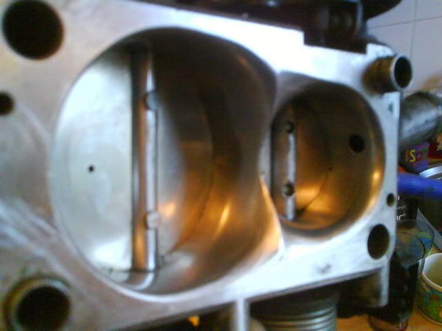

JMC 0 Posted September 18, 2007 Right next bit, before I start on it. Does the section between the 2 butterfly valves even need to be there?? This would make air flow into he smaller valve alot easier, and I can't personally think why it needs to be so high. Was thinking of removing material as outlined by the red line below. Quote Share this post Link to post Share on other sites
flusted 0 Posted September 18, 2007 yep ditch that bit, heres mine, sorry for poor quality backside Ive decided to refit the wedge so will se how it drives tommorrow Quote Share this post Link to post Share on other sites
JMC 0 Posted September 18, 2007 Those are really useful pictures flusted, and don't worry about the quality - I can see where you've taken the material off from it, which is the important thing. I hadn't even thought about doing the rear face :shock: . Looks as though I've got loads more still to remove. Quote Share this post Link to post Share on other sites

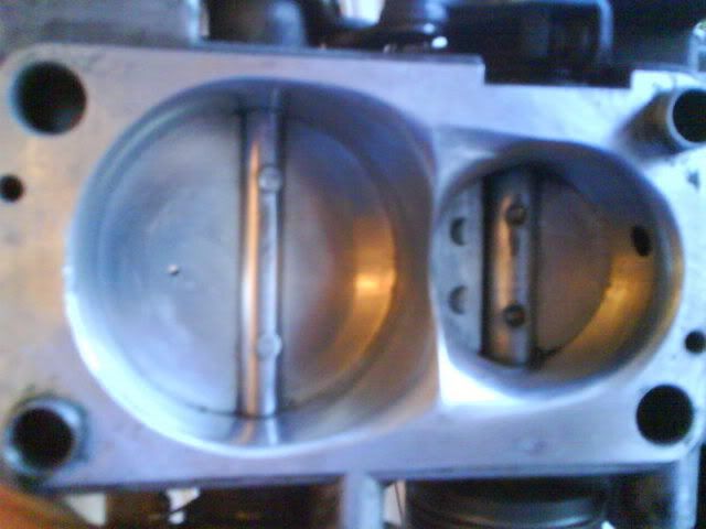

JMC 0 Posted October 3, 2007 Ok folks, here's an update of where I've got it so far. Just been polishing with the coarsest grade compound I've got - 2 more to go. Quite happy with how it's coming, but welcome any comments :D :D Going to take the other section to my local mechanic tomorrow to see if he'll put a bead of weld on to help with removing more material. Quote Share this post Link to post Share on other sites
flusted 0 Posted October 4, 2007 looking good, although it looks like youve shaped it as if the air is hitting it straight on, which it doesnt as the samller butterfly is off set. try shaping the divider slightly to the left as you look at it if that makes sense Quote Share this post Link to post Share on other sites

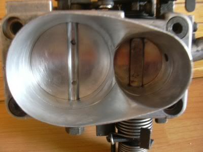

yellowG 0 Posted October 4, 2007 i purchased a spare G60 throttle body (as car is my daily driver) and ported the inlet to as far as i dared! this is a picture of it against standard inlet, its improved throttle response.... Quote Share this post Link to post Share on other sites
