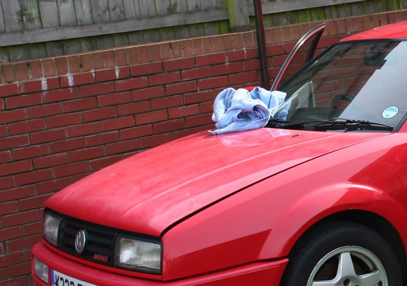

Veearrhsix 0 Posted September 15, 2010 Just wondering - from AG's website it says to use parallel strokes when applying the renovator polish - If possible could I use a 'rotary' polisher instead at very light pressure and slow rpm? :shrug: Quote Share this post Link to post Share on other sites
Veearrhsix 0 Posted September 21, 2010 viewtopic.php?f=17&t=93905 Found this thread... so might start by hand instead... A usual novice would try doing the whole car in a day, but think I'll just do approx 1/2 the bonnet for now. Quote Share this post Link to post Share on other sites

Veearrhsix 0 Posted September 23, 2010 Mmmm sexy Tornado red bonnet I don't think... (Driver's Front wing & door are in similar state.) Something to add to the "to do" list next week pending weather. Will begin with hand buffs of AG renovator, unless anyone chips in with a "Noooo use SRP instead!" type of thing... :pale: (Actually all plastic panels/bumpers, rear spoiler etc. are equally "erm") :pukeright: ...which is about right for age. Also can't get the knack of claying the car - takes ages and I get tonnes of cr@p sticking to the damn stuff, including that red T-cut wax I layered on it an age ago... :brickwall: Quote Share this post Link to post Share on other sites
Veearrhsix 0 Posted September 23, 2010 P.S. cheers for your views/experiences regarding this subject... still 1/2 & 1/2 on the AG Renovator but might just take Conker's approach... :scratch: A case of trying and seeing what works best at the end of the day (literally - wish I had a garage). :) Quote Share this post Link to post Share on other sites
