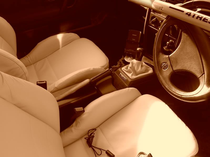

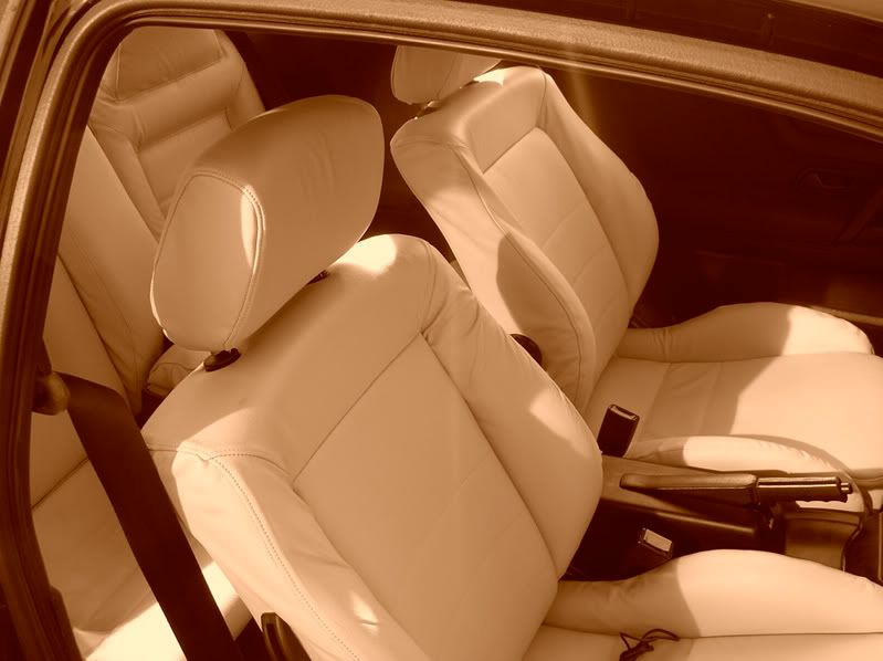

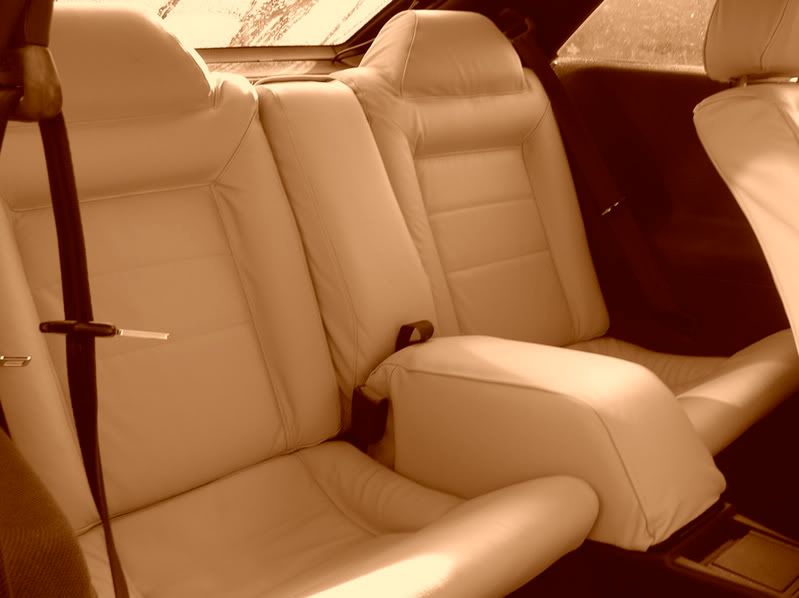

TimDoc 0 Posted October 23, 2007 Guys, nice to meet u all, not spoken to any of u before, i have just completely reupholstered my VR6 in cream leather. Luckily my old job was in textile design with heavy duty fabrics and foams so i had a few skills to carry into the job. A few tips for anyone going to do a home made job - once you hace dissected all of the parts of the seat fabric and sketched round them on the back of the leather hide, take those olde seat parts and try to stich them back together as neatly as possible and refit it to the seat, you will get a good idea of how you need to manipulate the materials. Also take note of the little notches that have been made in the edges of the patterns, they are there to match up with notches in their adjacent piece - v. important. Mke sure any sewing maching you use has feet that are both walking feet or you will scuff the leather at the thicker pieces. Also, one line of sewing is not strong enough in leather, it will cut through when any pressure is put on it. Once sewn you must turn both of the hems to one side and sew alongside the join, this will create a nice neat seam with a single paralell sewing line beside it. Sew all the seams allowing more hem than you think as this will create a tight finish with a neater look. There is no need to buy any foam pads for your new covers, just include the old ones with a new cover over the top! Below are the pictures of my finished result, I am about to purchase another interior that i am going to do in black leather. I plan to then see which i prefer and sell on the colour i dont. I will get them up on the forum when i have decided which ones to flog! Quote Share this post Link to post Share on other sites
Ginger60 0 Posted October 26, 2007 :shock: I am astounded at the fantastic result you got there man! Awesome well done its very inspiring I will give your advice some serious consideration in the process! Thankyou for the drooling pictures :lol: By the way how much leather did you need & the average cost? Cheers again. Quote Share this post Link to post Share on other sites
TimDoc 0 Posted October 26, 2007 you need to buy 3/4 full sized hides, there is a chap that i bought these hides from who's doind a deal on ebay at the moment but will also sell to you outside ebay (is kosher), they were hides tanned for jaguar! He's doin them for just under £60 per hide and has loads at the mo, but only in this colour, other colours are more expensive (black at £90 per hide). I paid £240 total with postage. If you do a good job you've saved youself between £2.5 and £3K! The co are called martrim (google finds them) give them a call as their website is crap, talk to josh hibbert and he will sort you out. Have fun. Tim Quote Share this post Link to post Share on other sites
Phil K 0 Posted October 27, 2007 Looks pretty good but it is a bit on the baggy side... is there anything that can be done to tighten the leather up on the foam? Quote Share this post Link to post Share on other sites
