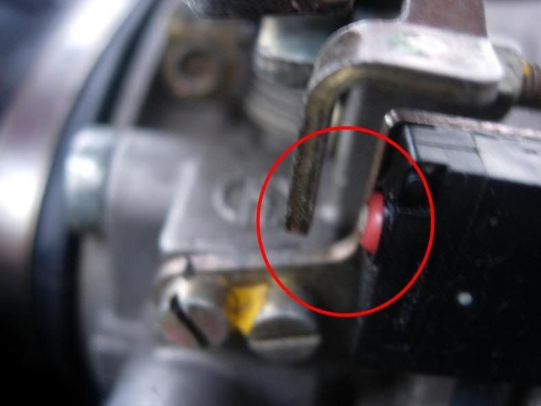

Step 1, the throttle housing is in this position:
Although you cant see it, the stop is on the switch in circle one, and in circle two the throttle is resting against the correct stop.
Step 2, i start the car. It idles at just under 2,000rpm. So i begin to move the throttle. Now instead of moving to the other stop immediately i have to move the throttle round approx. 20mm, then the throttle 'snaps' to the other stop, like so:
Step 3, i now let go off the throttle. The throttle does not return to the other stop as it should do, resulting in this:
Now the car is idling at 3,000rpm, obviously because the throttle has not returned to the correct position.
Step 4, this is where it goes odd. I push the stop back onto the switch, so the throttle returns the position that it should be in, like so:
Now with the throttle in the correct 'rest' position the revs drop, BUT, the revs raise and drop between 1,000 and 1,500rpm, it just keeps going up and down, up and down. Then when the move the throttle again, it doesnt hit the switch properly, so the car idles at 3k, then when you push it back onto the stop it idles up and down again
SOOOOOOOO, what the hell is going on?!?!? Obviously there is a problem in the throttle housing somewhere as it doesnt return to the correct position. But then when it does, the revs are very strange.
Any ideas?

I'd also be looking at the throttle position switch or more likely the wiring that goes into it.....on mine my bad idle was caused by 2 broken wires on the plug that connects to the throttle position switch.....not easy to spot though as the plastic sheath was still intact.
