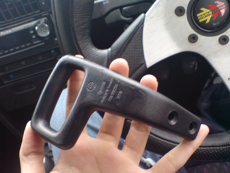

1. What are the fastenings for these? Both keep sliding off :/ Anyone know the size, or where I could get them from? cheers

The second picture is where the arm rest attaches to. I'm not sure about the fasteners for the first picture.
Screws for the handle are M5, 5 to 12mm long will be ok and they ideally need to be countersunk but it's not important as you won't seee them buried under the seat.
Unless you have a very stubby screw driver, I'm fairly sure that you will have to remove the seat to put the screws in.
Just undo the front nut and bolt on the seat, slide back and tip them against the rear bench.
