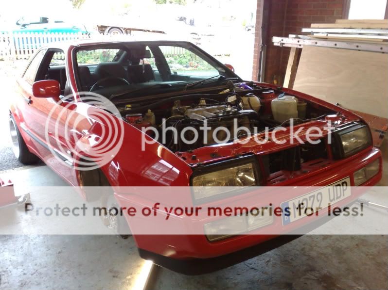

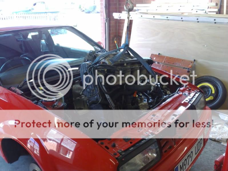

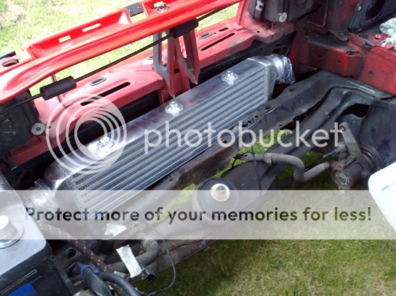

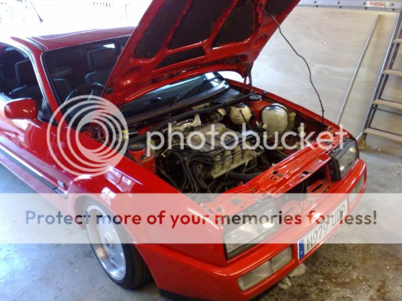

barryarginnraddo 0 Posted August 27, 2008 hi all, me and my 2 very good mates wardy and masey have started work on the 20vt conversion, we have got; agu lump with ko3s turbo. Qpeng diy kit qpeng down pipe fmic heres what we have been up to; Quote Share this post Link to post Share on other sites
