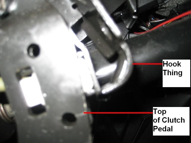

MikeVR6 0 Posted July 3, 2008 Pulled the under-dash trim off. Similar to the fault was8v linked to, my the pedal is coming right up and stopping on the metal frame of the pedal box. With the trim on, it stops on the back of the little plastic shelf under the steering column. boostmonkey thanks for the offer. Could you take a look at your setup and tell me if there is a plastic stop or something normally on the frame where I've described. Drove the car again at lunchtime and gear-change is fine. Quote Share this post Link to post Share on other sites
Supercharged 2 Posted July 3, 2008 There is a plastic bush missing - likely to be in the car somewhere I would have thought! Quote Share this post Link to post Share on other sites
MikeVR6 0 Posted July 3, 2008 Found an old thread from Mr. Cheesewire describing the same thing. The metal pedal stop had bent over the years. Bent it back, all ok now. Pedal high no more! :salute: Quote Share this post Link to post Share on other sites
