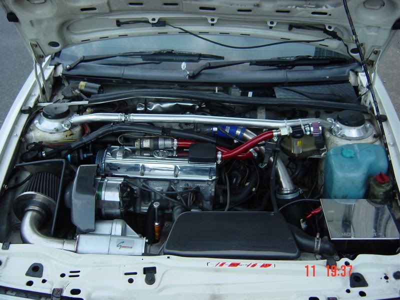

BigTartanJudge 0 Posted January 15, 2009 I have a SPARCO alloy adjustable front one for my G60, it looks ace and was reasonably priced. Got it from Demon Tweeks, it was marked originally for a MK2 Golf 16V, but as I had one on my last G60 I knew it fitted, see below: Quote Share this post Link to post Share on other sites
Jay2 0 Posted January 16, 2009 That looks great mate! Was it a straight bolt on job or did you have to move anything out of the way? Quote Share this post Link to post Share on other sites
