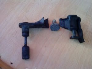

I'd still consider replacing that plastic part the selection cable clips onto, it may be breaking up underneath and that's what lead to the nut undoing. I've seen loads that look fine, but when you remove them they are on their last legs, if it breaks the car is pretty much undriveable, it's almost worth keeping a spare in the car :)
Found the problem this evenin, it was the adjustment nut on the top of the box itself. Tightened back up, hey presto! Which means I can still make it to UD on Sunday! :clap:
That's exactly what happened to me and left me stranded with only 3rd and 4th useable. Part no 1J0-711-256.
Gruvenparts.com do a steel replacement but its 86 bucks and given the strength of the pound atm its a bit of a shocker.
