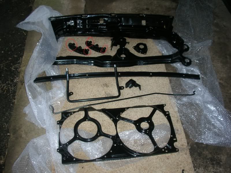

Mawrick 0 Posted April 28, 2009 ok, thnx, dis you happen to get the rubber "bearings" that fit on the parts I marked with red circles on your pic new?.....I was at a local stealership today, and they said it was discontinued, so if anyone know if it's still possible to get them new, it would be greatly appreciated. Quote Share this post Link to post Share on other sites
bruny 0 Posted April 28, 2009 Should be available, part no. 191 199 233, if not try febi, they make replacements Quote Share this post Link to post Share on other sites
Mawrick 0 Posted April 28, 2009 hmm, he found them in the parts program, but when he was trying to put in an order it said discontinued, however I'm a bit unsure if some have trouble using these order systems, if anyone is in a stealership in the uk one day, maybe one could ask to check ?......:), would be nice to get it original, but maybe febi is much the same quality?.... Quote Share this post Link to post Share on other sites
