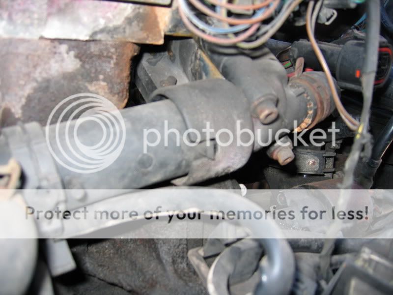

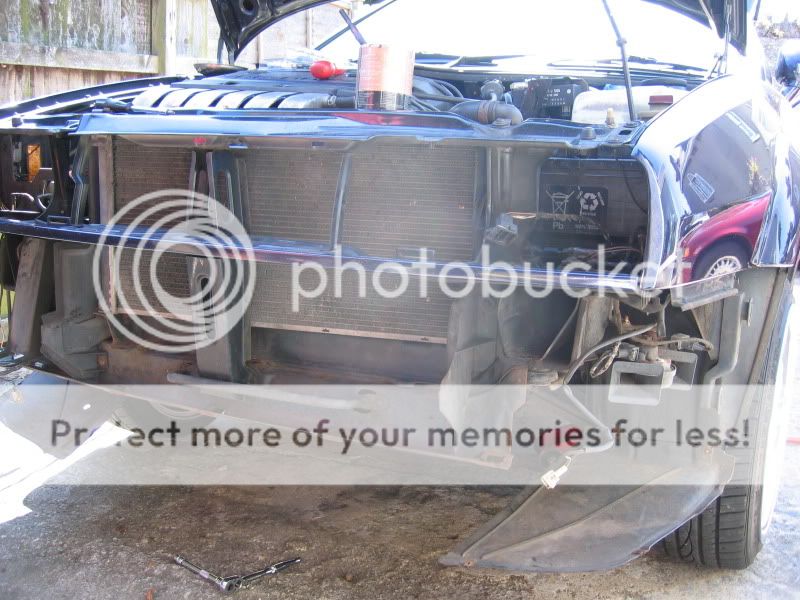

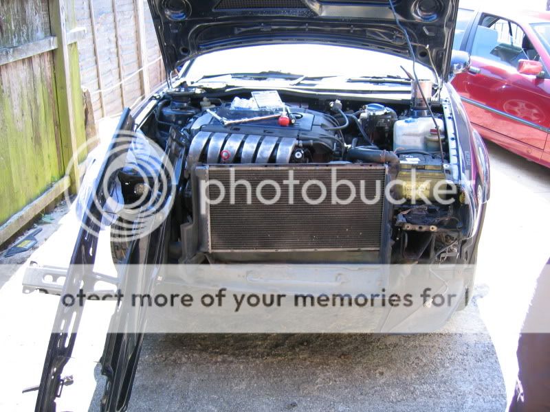

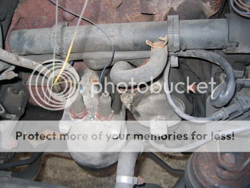

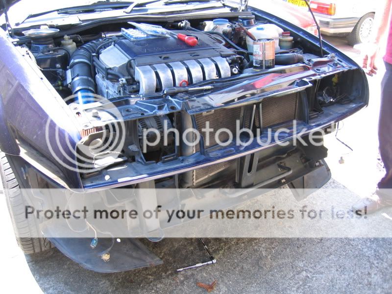

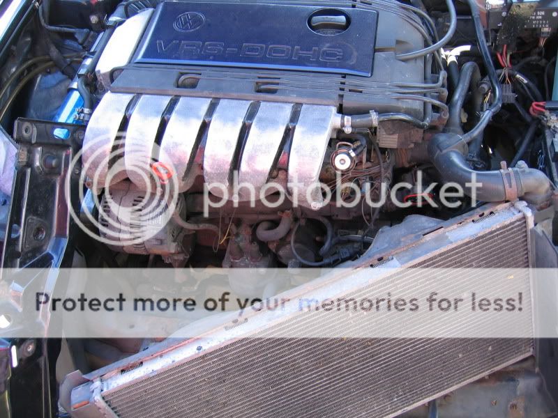

8vMatt 1 Posted June 2, 2009 Yesterday I went over to my brothers place to investigate the slight water leak from the front of the engine block. As I'm a complete novice at mechanics of cars, I've never attempted any servicing or stripping a car before. Now I've got a Corrado, I was determined to learn and get more confident at this kind of stuff. My brother is a qualified mechanic, so I can't go too far wrong with his help So, starting to strip the front end down, As we only needed to get access to view the engine, it wasn't necessary to disconnect the bonnet release cable. I've heard these are a pain to refix. Next up was to carefully lift the rad over to one side, again didn't want to disconnect anything, After an age of searching for any leak at all, only a tiny drip was visible between the crack pipe and thermostat housing. No damage was visible from the plastics, so we made the guess that it could be the O-ring sealing the two. Thats pretty much all up to date at the moment, the alarm and dead battery was sorted out as well. Oh yeah, changed the spark plugs and the old boys were shagged! A couple of ends had disintegrated, once changed the idle problem was gone completely. Had been stalling when coming to a junction or standstill. Drives smoother and pulls very nicely Cheers for now. Quote Share this post Link to post Share on other sites
B41LEY 0 Posted June 3, 2009 Good pics mate! I've got a leaking radiator that is currently bodged with rad-weld, by removing the passenger headlight i can see its corroded at the bottom, i've been dreading the job of replacing it! Was it easy enough to remove the bumper/slam panal etc? Your pics will be a great help when the time comes! Quote Share this post Link to post Share on other sites
8vMatt 1 Posted June 3, 2009 Hi B41LEY, Even to a novice like me, it was a very easy job. First there are two 17mm bolts either side of the car underneath that hold the bumper legs on. You might need a big bar to undo these as they will be tight. Release the plastics that are under the car that attach to the bumper and inner arches if they are there. Pop off the indicators and release the wires from those and maybe the fogs (trying to remember!). At the bottom of the drivers side on the bumper you might have an air temp sensor, wiggle that free from the bumper. Back down under the car, you will see a long strip of metal running across the car, undo this and pop it off. Now you are ready to pull the bumper forward and off. Its a two handed operation. The slam panel will have twelve bolts holding it, two either side at the top, two either side under the headlight, one either side into the wing and two in the middle at the bottom. There maybe little bits of trim that need removing but that should get you started. Do the same as me and don't worry about removing the bonnet release catch, just move the slam panel over to one side. Hope you get on good and if I've forgotten anything then I'm sure the missing info will be filled by someone. Quote Share this post Link to post Share on other sites

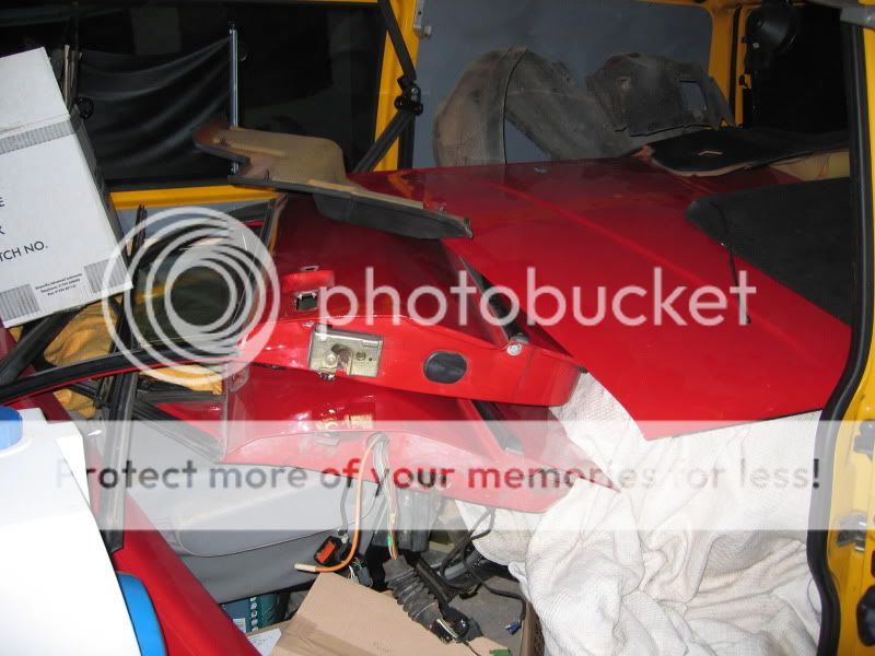

8vMatt 1 Posted June 3, 2009 Hi there folks, Been shopping tonight Didn't realise quite how much I picked up until I started unloading everything this evening. Some things I need for spares but there will be a surplus of bits and bobs. Feel free to shout if you recognise a part that you need but don't be offended if I don't want to sell it! Once I go through it all, I'll do a detailed for sale thread. Here goes- And some plastic arch liners and a rear bumper as well not in a photo. What a long evening and about a 110ish mile round trip. Bed now, knackered! Quote Share this post Link to post Share on other sites

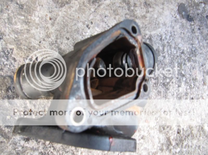

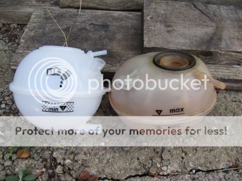

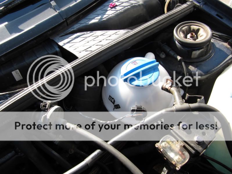

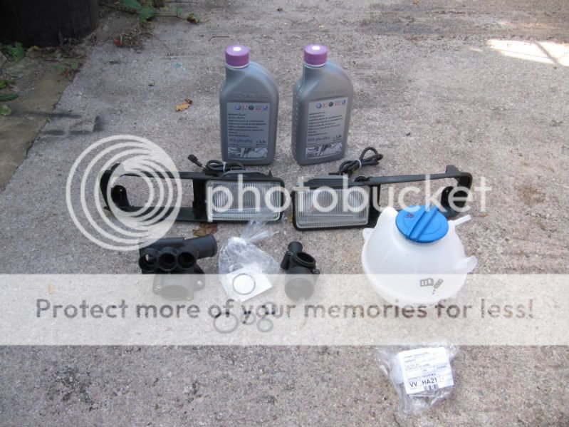

8vMatt 1 Posted October 3, 2009 Wow, its been a while since updating things. I'll have to do a bit of a quick skip through things to try to keep it brief and to save my fingers falling off from typing too much :gag: :) Firstly I had the whole car machine polished to remove swirls, scratches and the like. My mate did a great job on it, really brought out the colour- I finally got round to sorting out the water leak on the engine, it turned out to be a broken section in the thermostatic housing. All bits replaced with genuine VW parts. While I had the cooling system drained, I had the chance to carryout the mk4 Golf header tank mod. Especially as mine was poop and you couldn't see any levels. Used G12 coolant to fill back up, I want to do things properly with this car. Got my hands on a pair of fogs from good old Ebay as well. Just a couple of shots taken the other night, I picked up a set of In-Pros and an original Storm grill that I wanted to freshen up the front end. The lights are covered with smoked headlight protectors. I've not been getting much love for these lights but I like them, especially as they run with HID's to make a big difference to night time driving. I know this car is in need of a serious bit of lowering, that will happen one day, just not one soon :cuckoo: I fitted a secondhand sub and amp from a mate that gives good depth to the music without it being a chav window smashing experience, a 12" JBL sub in a box and a Kenwood amp, no pics but you know the thing 8) Been out today and picked up a new toy. That brings me upto date now I think, thanks for looking all. :salute: Quote Share this post Link to post Share on other sites

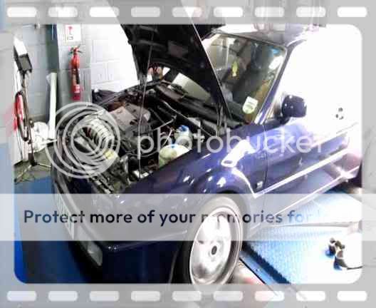

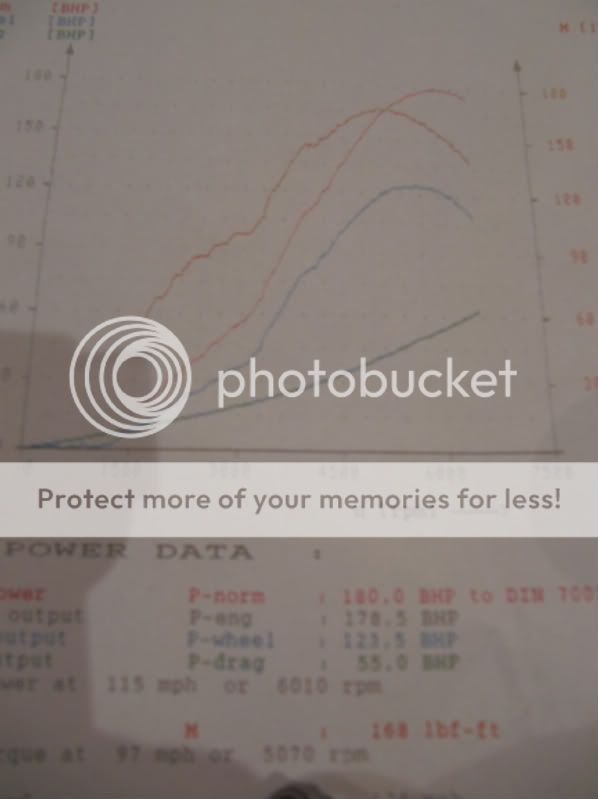

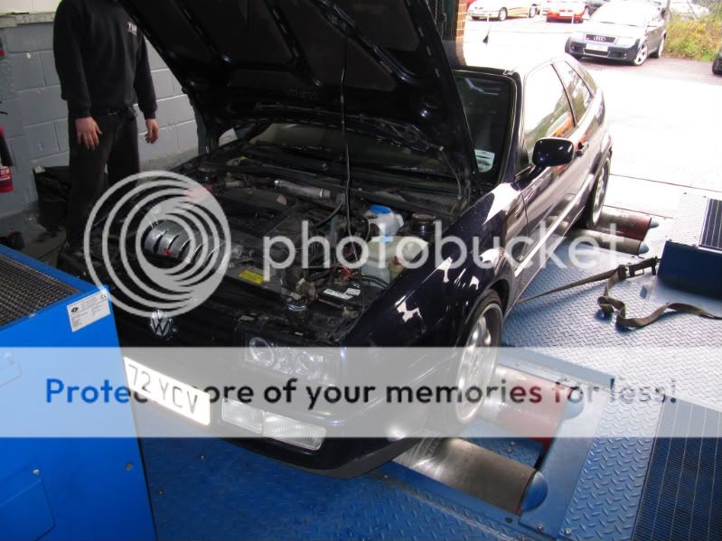

8vMatt 1 Posted November 14, 2009 Been to TSR today, had a Rolling Road test done for the first time. Awesome time and some amazing cars and figures produced, an Audi RS6 had 413bhp, a Leon Cupra R had 364bhp! My figures aren't as good as most on there today but I'm reasonably happy with what was produced- BHP-180 exactly Torque- 168lbs Was a little surprised at how hard they push the cars to get the figures, suppose they have to, to get the right readings. Mine revved to 6590rpm :gag: A couple pics and a quick Vid of mine- Quote Share this post Link to post Share on other sites
Emkayvr6 0 Posted November 14, 2009 Hi Matt, those figures aint to bad at all, down a little bit but nothin major :clap: Like the vid, 1st time i've seen a vr on the rollers, notice how much the engine moves in the bay, especially when coming off the gas. Will look smart with the new rims on there :grin: Cheers Mart Quote Share this post Link to post Share on other sites
8vMatt 1 Posted November 14, 2009 I know, I was really surprised myself by the movement of the engine. There were others there that moved loads more than this :shock: Quote Share this post Link to post Share on other sites

Emkayvr6 0 Posted November 15, 2009 I know, I was really surprised myself by the movement of the engine. There were others there that moved loads more than this :shock: I Knew it moved but didn't think by that much, spose i've never seen inside a bay of a vr when been doin that much rpm :lol: Quote Share this post Link to post Share on other sites
