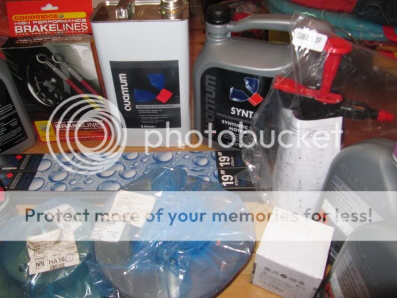

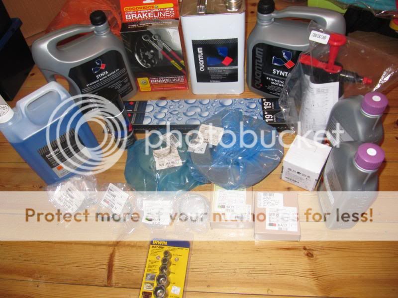

Well I went a little mad down at the local TPS and a couple of internet sites collecting parts for fitment and for crucial stock (thats what my brother calls hoarding of parts!). Firstly I needed to get everything needed for the mk4 rear brake changeover.
Rear Discs 357615601B
Bearings 191598625
ABS rings 1J0614149
mk4 pads 1J0698451P
Carrier bolts N0199123
Cover 1H0501639
Now just a few parts for a rainy day.
Synta oil ZGB115QLB00406
Coolant G012A8GM1
Screenwash ZGB00QSWC05L
White grease ZGB00QWG00400
19" Wiper blades (front) ZGB00Q955525J
Brake cleaner dispensor ZGB00QBCCDISP
5Ltrs Brake cleaner ZGB00QBCC005L
Also bought some of the Irwin bolt removers just incase I might need them and a pair of Goodridge braided hoses for the mk2- mk4 conversion. Don't buy them off ebay, cheapest were £68. Amazon is the place to find them- £28 delivered and they arrived on the tues after I ordered sunday. Very happy with them.

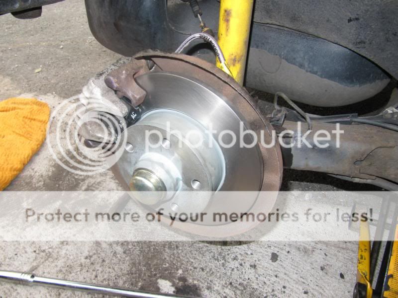

The mk4 rear calipers have now been fitted. A few little hiccups along the way but for actual fitment, it all went like clockwork :smug:.

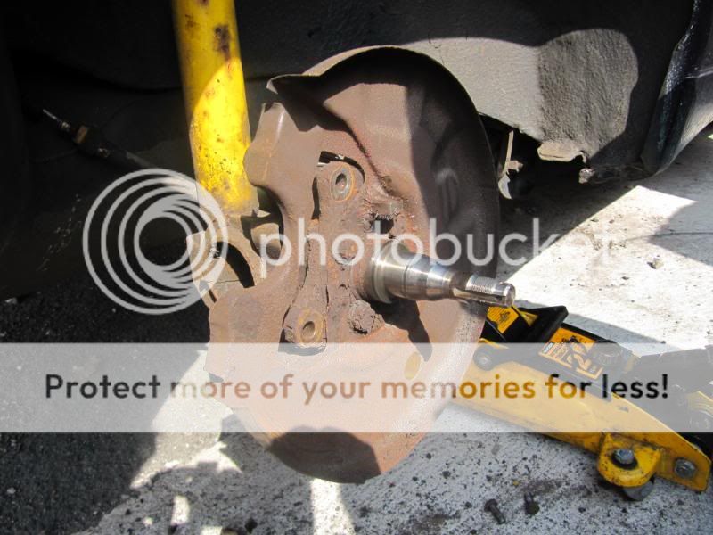

Stripdown showed everything to be in surprisingly good condition, I expected the disc guard to be rusting away as I think it could be original or at least not changed for a long time.
The old shagged out disc with lots of grinding from an equally knackered pad :bonk:

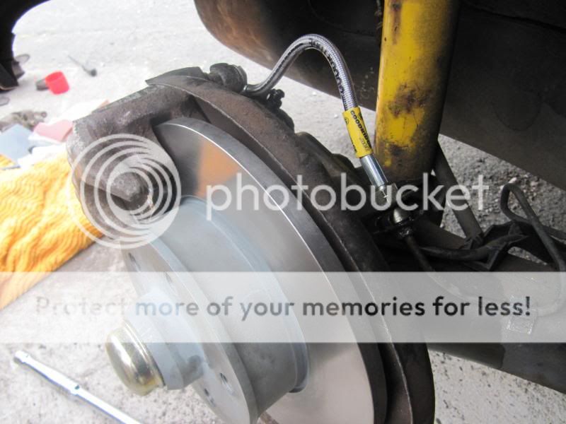

Had a bit of fun removing the caliper bolts but luckily they shifted in the end. Glad I bought new ones. Then found a couple of the carrier bolts had seized in the sleeve due to water ingress, what a job they were to free. Built the new discs up with the bearings and re-assembled no troubles. The Goodridge hoses were spot on and fitted great.
All back together-
Had a few troubles with bleeding, air in the system. My mechanic mate came over today and brought his proper bleeding kit. Wow, what an amount of air that came out of there! Much better now but its still a bit spongy. I think things will settle down after a couple hundred miles. But as a conversion, this was pretty straight forward and will prove to be a good move.
