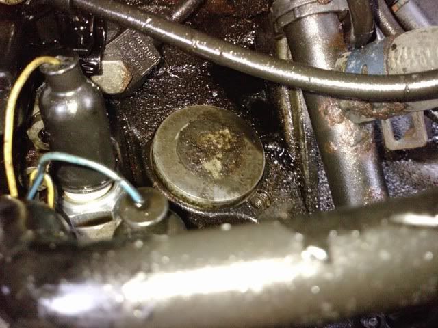

Well I think I might have found the real reason for this.
Got a txt off my dad saying their was oil on the drive were I was parked. So I looked under the bonet and there was oil every were had a look round the engine bay and found this was very loose and the part that holds it on missing
After looking round the engine bay I found it luckly and managed to fit it back on, filled her back up with oil.
Its looks like its coming off the gear box as when you take it out you can see some cogs. Its situated just above and to the right of the oil filter.
What a night, but all sorted now, might be worth takeing a crash course in mechanics :D
i forget the name but that lump of metal sits on top of the oil pump drive which itself is driven from the intermediate shaft, the cogs you see is the change in direction... tbh honest i don't know what would happen if that metal thing wasn't on when the engine was turning over??
Well I saw it was loose and pushed it back in and was fine ( didnt even cross my mind there was something to hold it on) truned the egine on and it just popped out, not completly but enough to notice plus chucking out oil. Turned it off saw a screw slot and hunted for it and sorted it out.
my theory on why it was running poorly is that when that plug was removed you'd have been sucking air through the engine block rather than through the metering head - hence limited fuel/ stuttering :D
If memory serves me correctlythats a blanking plug for a distributer thats used to to sit theere on some variations of the block. The dizzy on my Scirocco was there.
