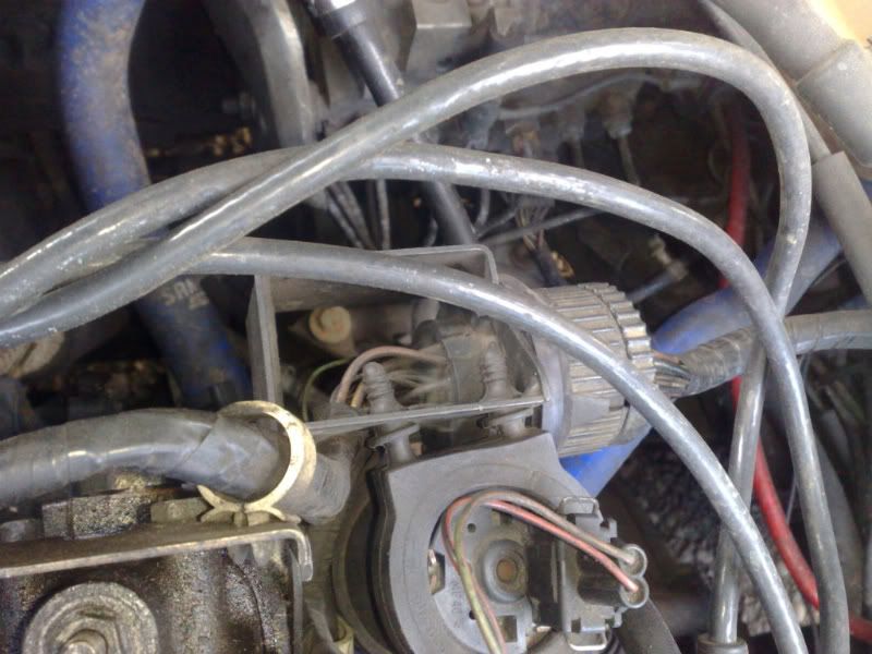

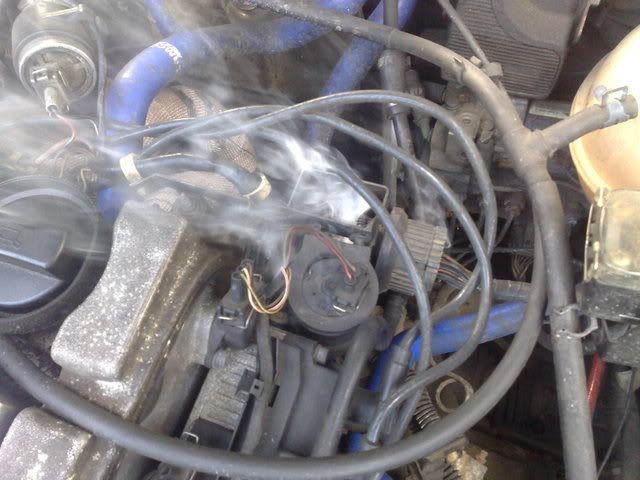

Coming from work today with my old man, the car ran really rough, worse than before, pulled into the drive of my folks house (just happened thankfully) and alot of white smoke came out of the bonnet, opened the bonnet to find this!
Now I had replaced the aux water pump 3 months ago, but this was no problem in removing and fitting, a few wires have melted by the looks of things, so looks like a that side ( i hope ) of the loom needs replaced. Or could it be water leaking into the wires???
I let her cool down and tryed to see what it could be, i turned the igniton on and the immobliser wouldnt switch off to allow the car to fire up, then the weirdest noice came from around the area, it looked like it was coming from the abs pump but it was actually closer the the engine, it was a high pitched rumbling noise??? By this time I was completely and utterly lost!
Now I know my basics but this im stuck on, what has happened to cause this, and what this noise?
Recently the oil and temp gauges stopped working, could be linked?
I have my old spare raddo for parts so I will try and use the loom that goes to the throttle body, coilpack,etc

I suppose it was lucky you found it when you did, could have been much worse. Good luck in repairing it.
You have removed or disconnected the battery haven't you? Just wouldn't want it to get any worse over night.
That connector can suffer from water ingress. If you are lucky it's only the engine side of the loom that has been damaged.
I'd try taking the connector apart and checking the wires on the car side of the wiring loom, and look out for a good engine wiring loom....
That was the 1st plan for tonight, take the the engine loom off my old raddo and see what happens, but yeah im praying no damage has been done to the other side of the loom or i am well in deep horse sh!t.
Water ingress you say? hmm thats strange becasue the old aux water pump was leaking real badly, new aux water pump seems bone dry............ :?
