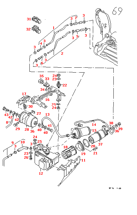

timthetinyhorse 0 Posted July 11, 2009 if the lines are the same on a vr as on a valver i had a problem with the lines between pump filter and accumultor, the pipes are copper ends with plastic bonded midway (i presume this is to allow flex) i had a huge leek on mine and found it to be that the bond had broken on the pipe. fresh pipes fitted and probem solved, if it is the problem i would change both pipes as a precaution but be prpared for the two sections i paid £70 from the dealer if it is the same im talking about parts 13 and 14 rob Quote Share this post Link to post Share on other sites
