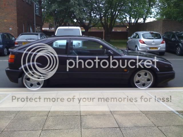

next month im planning on putting a vr engine in my valver
want to keep my 280mm 4x100 brakes for the moment so wont be going widetrack
will i need the vr front and back subframes to fit the engine???
cheers james
body work is mint + want more power so a vr conversion seems a more cost effective way than throwing money at a valver engine
dont want to swap the brakes atm as if do it means having to get new adaptors for the wheels, plus ive got some 4pot brembos going on once ive finnished the cad drawing for the carriers
