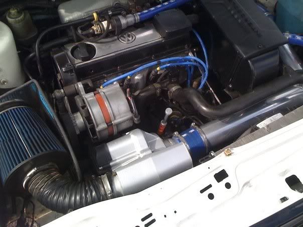

Rob_G60 0 Posted August 25, 2009 well the car is back and running again Quote Share this post Link to post Share on other sites
vwdeviant 0 Posted August 25, 2009 So what was it? :shrug: Gota love Darren's service! Edit: Think about swapping the cone fro a stock filter & box, will give a lot more life to the Charger too! :wave: Quote Share this post Link to post Share on other sites
big ben 10 Posted August 25, 2009 looking very nice :D Quote Share this post Link to post Share on other sites
