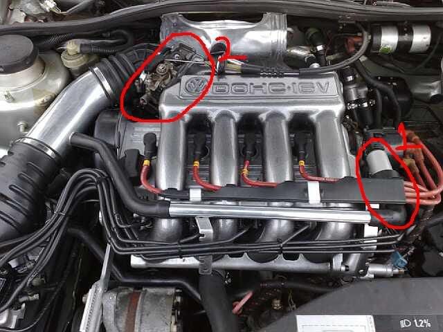

nmahi 0 Posted October 4, 2009 1. ISV 2.Throttle Body Quote Share this post Link to post Share on other sites
Abdul 0 Posted October 4, 2009 You're a legend mate!! Will have a fiddle tommorow and see what i can do... Quote Share this post Link to post Share on other sites
