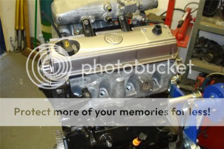

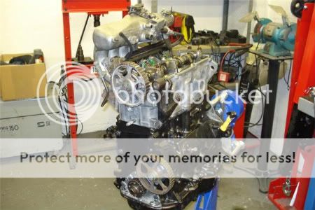

Anyway a few weeks later I was out for a drive when what do you know a large bang came from the engine and then a load knocking noise, this turned out to be one of the pistons disintegrating and chunks of metal being compressed in the engine. :bad-words: :censored:

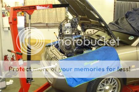

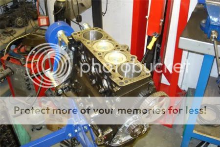

So down to my mates garage again! the engine got stripped down and I dropped it off at stealth for the bottom end to be rebuilt, at the same time the I had the head flowed. Whilst this work was being done I had the supercharger checked and then a Stage 4 rebuild done, also sourced a standard airbox to replace the Jabbasport induction kit.
A couple of weeks later we had the bits back and the engine was rebuilt, you can also see the TT wipers fitted...
Engine out

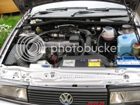

Engine after rebuild
Once all back together the car drives spot on (so it should). :clap:

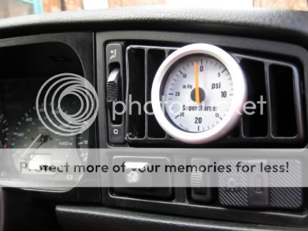

Purchased a Boost gauge from TomD fitted today (managed to get it to 12psi!)....

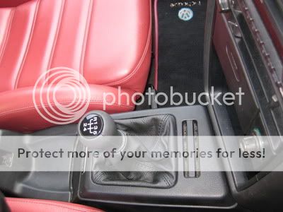

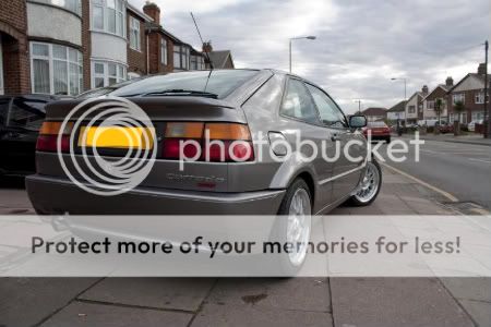

Thought I would post a few small updates, firstly I have replaced the red gear knob with a new vw black leather one (£30 with discount, usually £36) along with a gaitor I purchased off ebay:

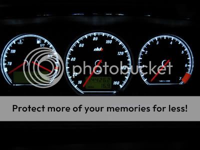

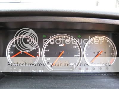

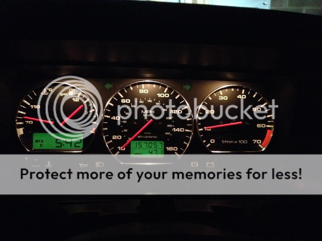

Fitted some ddi dials purchased in a group buy last year, along with this I also sprayed the needles with flourescent orange paint and mounted a uv bulb where the original bulbs used to be, the needles now light up along with the new dials. I have taken a pic but it doesn't doesn't really do them justice

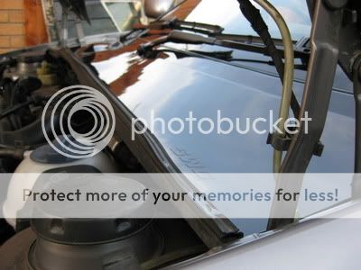

I have fitted a SWG scuttle panel again I purchased in a group buy last year, it was a bit tricky getting it on but its a vast improvement on what was there before:

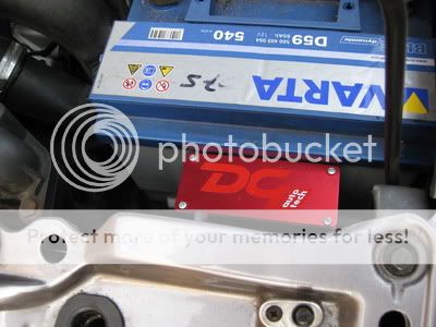

Also an updated headlight loom from dg auto tech fitted, very good quality bit of kit:
I still have a problem the the MFA screen it is stuck on the time, we have so far replaced the wiper stalk, clocks, ecu and tested a number of sensors which seem to all be working. We have tested that when you press the wiper stalk you get a signal at the back of the clocks which you do.
Does anyone have any ideas what to try next? There is a blue plug which the boost pipe plugs into on the back of the clocks which I haven't replaced yet I assume it converts the boost into an electrical signal, could it be this?

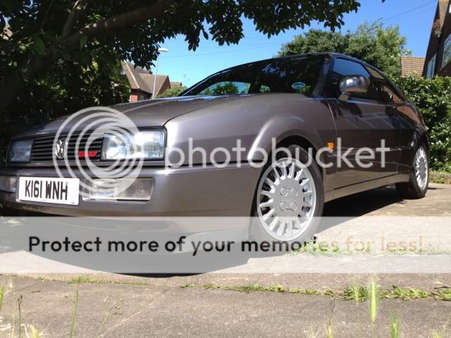

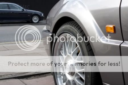

A quick update, I have sold the keskins and gone back to original sebrings, had them refurbed and stuck on some continental premium contacts.
Still sits a bit low even with the kw's wound right up, not quite sure how I'm going to get it raised further!

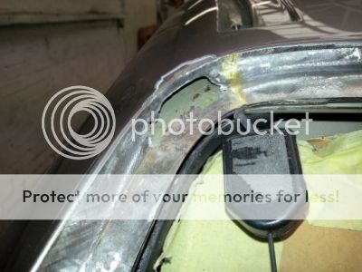

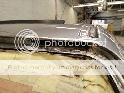

A bit of an update, started getting water in both footwells every time it rained played around with doorcard scuttle area and some other things trying to locate the issue. In the i traced the leak back to the top of the windscreen which i found a bit strange until i pulled away the trim round the windscreen and found a 2 holes and a serious amount of rust:
A bit of welding and rust treatment required but should be able to get back out in the rain shortly without getting wet!
Unfortunately the screen cracked when it was taken out so that will have to be replaced to, should have it back from the body shop shortly.

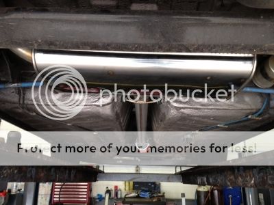

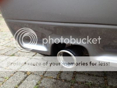

Another update, the exhaust was coming to the end of its life so I got it replaced yesterday. Also had a sports cat fitted as it seemed to raise questions at mot time not having one, never got a straight answer on what the cut over date was for having one. Exhaust is a powerflow 2 box system and so far very happy with it not to noisy until you really put your foot down, then again the last exhaust was blowing out of every joint so it was always going to be quieter than that. A couple of pics attached:
Cheers
Scott
the changeover date was in 1994. Yours would have been fine being a 92 i did'nt have a cat on my 92 16v. new exhaust looks well though mate. lovely and shiny lol
I was told/read that it was at some point in August '92 and mine is registered at the beginning of that month. To be fair there doesn't seem to be much difference between having one and not, might have something to do with the old exhaust being s*#te though. Keeping it clean will be the challenge!

Spent Sunday removing the DDI dials and reverting back to almost standard, i have replaced the green filter with a white one, kept the orange needles and the dial surrounds
Never really took to the DDI dials think this is a good compromise. Does anyone know if there are heater control panels without the green filter in, i'm sure i have seen them somewhere before?

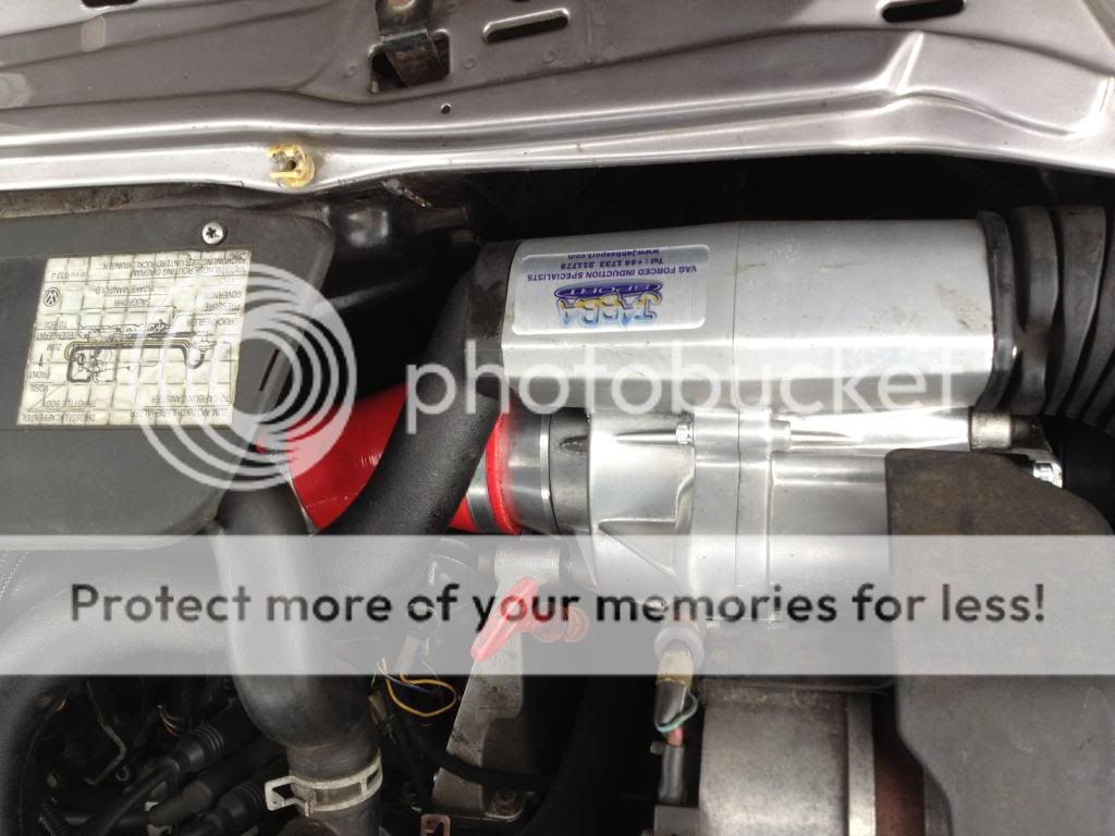

This week its back in the garage having the spare charger put in so i can get the other one serviced (both stage 4 so shouldn't be any difference)

Had a bit of an issue with my spare charger, the boost it generates ripped the silencer box on the outlet off its fixings! So replaced the unit with a rsr outlet and must say it really improves the response of the engine and the charger sounds awesome
