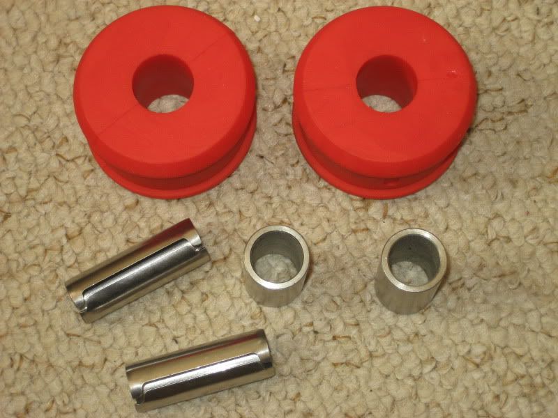

I have these wishbone polybushes for Golf 2/3 and as I was offering them to corrado16v18 under the impression they also fit the Corrado could somebody confirm they are suitable please, PolyRACE code on them is 064.
They don't fit the Corrado properly. As has been mentioned the Corrado subframe has the little horseshoe shapes in the rear bush section to hold the bush in place. That type of poly bush is a complete arse to fit in the space, as it doesn't have room to clear the horseshoes, so you either have to just ram it in, or trim it to size.
If you are going to fit them its very important to make sure the sleeve in the centre of the bush is the same diameter as the OE Corrado ones, otherwise they will move around in the subframe. The thin spring-sleeve in the picture is only for the mk2, and not needed for the Corrado because of the afoermentioned horseshoe bits.
