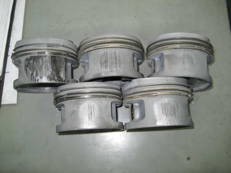

Pistons - Badly Scored on one side. Smooth on the other

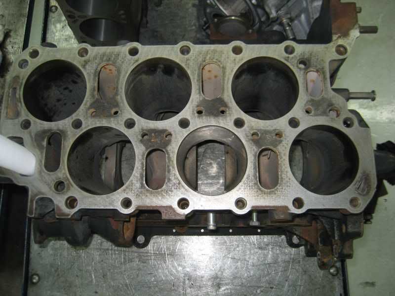

Cylinder Head - All the bores are badly scored

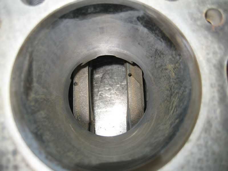

Cylinder Bore Closeup - Really need to run your finger over the bore and "feel" the damage

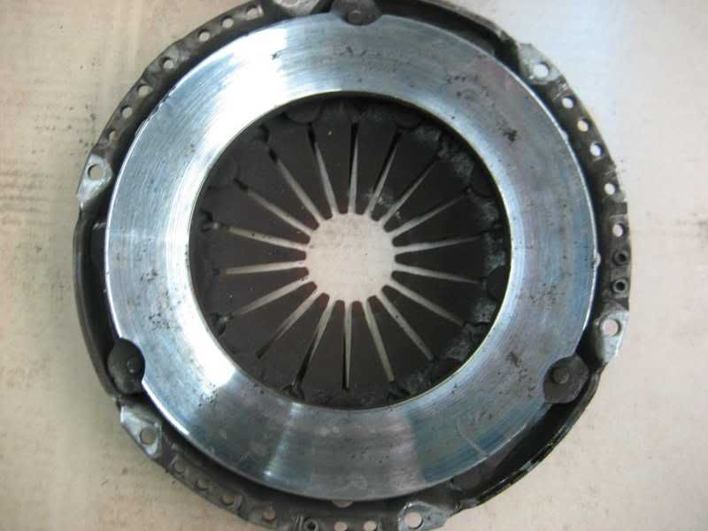

Clutch - Borderline

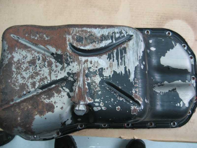

Sump - Battered to Death!

i think you can just get 1mm oversized piston ring set from the dealers.so you may not need to replace all the pistons ,only the damaged ones.
