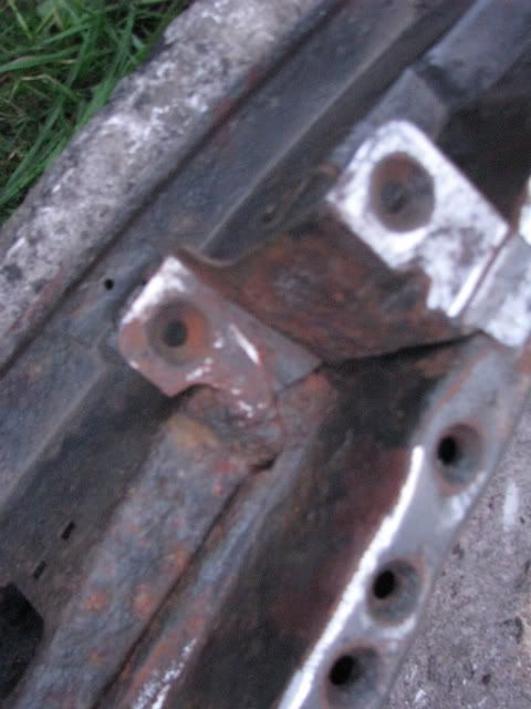

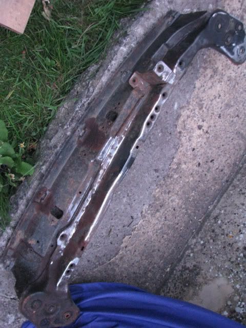

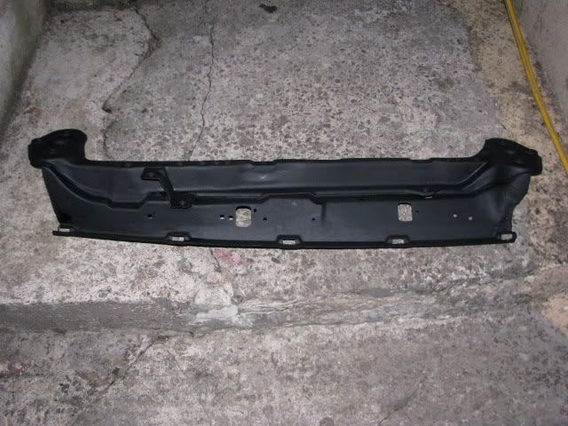

I've got the crossmember and the rad mount off and cleaned them back to shiny metal, primed them ready for painting and will be coating them with rust-oleum and then anti-chip paint.

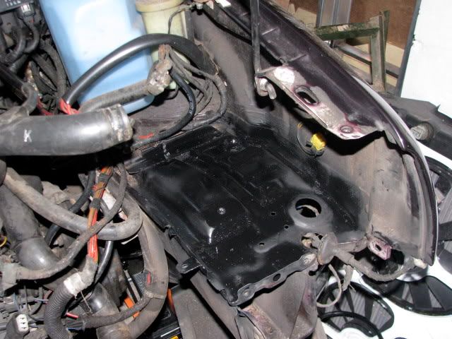

The battery tray has had all rust removed and been primed ready for some hard wearing paint - prob the anti chip stuff.

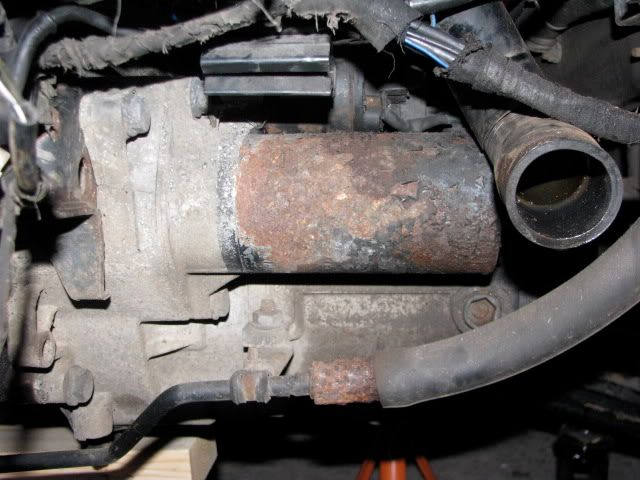

The started motor (i think it is) looks really rusty and a pipe below it also - doe these need cleaning off or anything else doing to them.

Before de-rusting
After..
The battery plate

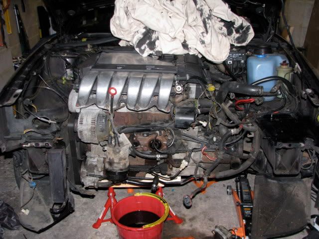

The car as it stands
The starter motor??

be carefull with stonechip over rustoleum ...will prob cause it to crack as stonechip is usualy thinners based

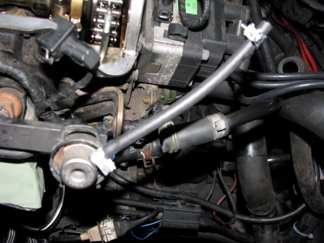

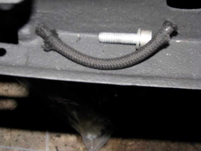

The intake manifold vaccum sensor (i think it is) hose is a 3-4mm (internal diameter) that is a braided black rubber hose - see pic below, has frayed lots so replacing - is 4mm fuel line ok as a replacement?? - have fitted one end and its fine for fitment?
Old
New

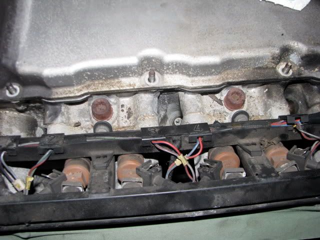

These rusty bolts - guessing they hold the head onto the block i'm guessing, they look in pretty poor nick - if not doing anything down there i guess you just leave well alone?

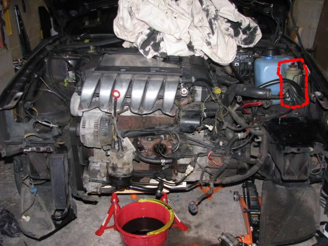

Which coolant should i use - got 3/4 of a bottle left from last time that i got from gsf that has pink fluid in it - but all the writing is in german - that may be a good thing!!??
The bottle that i have ringed in the picture - guessing that this is the powersteering fluid - whats the best and how much is needed??
