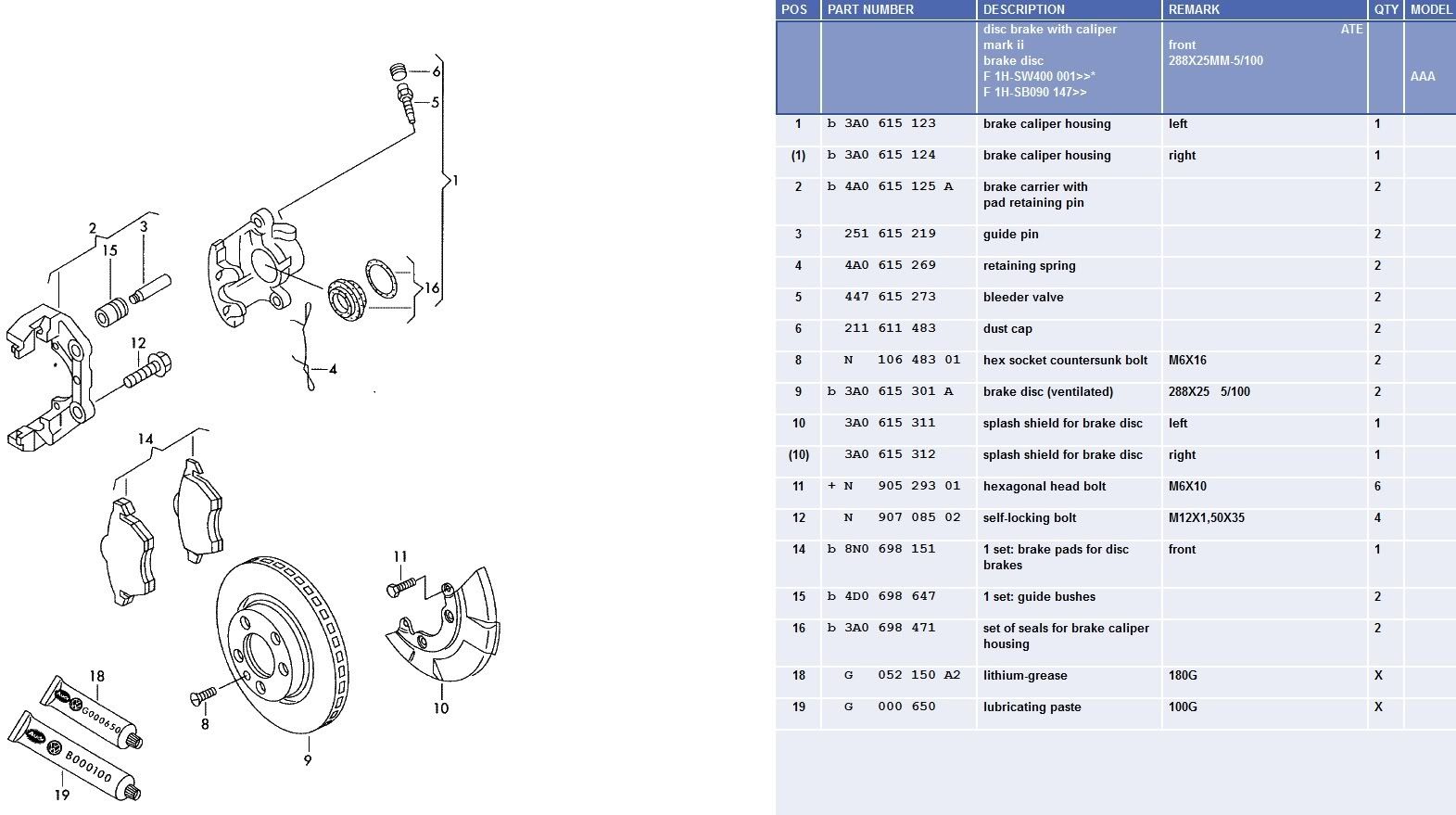

Fanjita 1 Posted May 19, 2010 Hi, I have just recently purchased a set of 288mm brakes for the front, one of them is missing the dust cap that sits on the end of the hard rubber sleeve that houses the slider. Without a car reg number or chassis number I doubt my local VW will look up the part for me. Would anyone with ETKA be able to find this for me? I have searched and searched as I thought there was a thread with this information in but now can't find it. Not sure if I can just buy the dust caps or if i have to buy the rubber sleeve also. Cheers, Jim Quote Share this post Link to post Share on other sites
MattPc 0 Posted May 19, 2010 Hers a link to a screen shot of what you are after. Matt http://i139.photobucket.com/albums/q282/twr_photos/288discinfo-1.jpg Quote Share this post Link to post Share on other sites
Fanjita 1 Posted May 19, 2010 Legend, thanks a lot :salute: Quote Share this post Link to post Share on other sites

mattnorgrove 0 Posted May 19, 2010 Bit OT here but that screen shot shows a tube of lithium grease, do the slider pins HAVE to use this type of grease? Is normal grease totally unsuitable??? Quote Share this post Link to post Share on other sites

V-Dubstar 0 Posted May 20, 2010 Bit OT here but that screen shot shows a tube of lithium grease, do the slider pins HAVE to use this type of grease? Is normal grease totally unsuitable??? I read somewhere that lithium based grease degrades rubber, silicone based is best! I used red rubber grease on mine :) Quote Share this post Link to post Share on other sites
