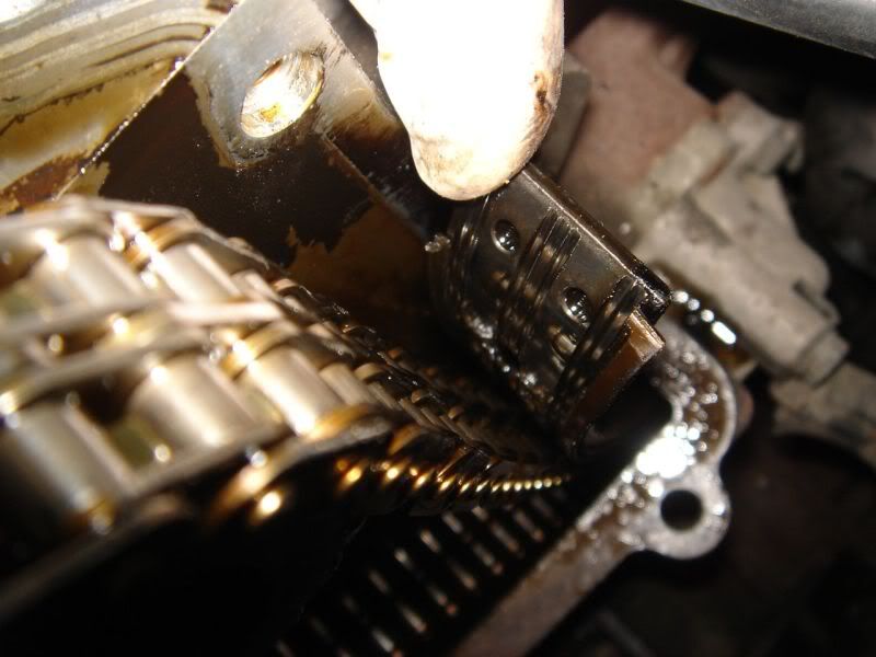

SamG40 0 Posted June 1, 2010 This was my top pad tensioner at around 112k. We had no noise at all from the engine but this was what was left of the pad. Fair enough maybe there is a bit of scare mongering but I would advise that at the least the top tensioner is checked. It wont take long or cost anything. Is it wort the risk? Quote Share this post Link to post Share on other sites

Kevin Bacon 5 Posted June 1, 2010 No one is worrying about it, least of all me. All we're saying is check the tensioner, that's all. Why is that scare mongering? If all it takes is an hour's labour to remove the intake and rocker cover and have a look at it, why is that such a big issue? I think the majority of VR6 owners would rather know for sure their engine does, or doesn't need chains / pads, than just stick their head in the sand about it because people like you say "Yeah it's quiet, I don't rag it, so must be fine". How do you actually know that without visual inspection? At the end of the day, do what ever the feck you like with your engines. We're only trying to help, but if it's not wanted, fine, I don't give a schitt. Bury your head in the sand about the headlight switches aswell. I think any advice about avoiding a potential car fire is very welcome, but you know best. Quote Share this post Link to post Share on other sites
