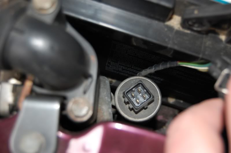

ok now I see you aren't getting 12v on the clutch. I would start by bypassing a.c. pressure switches and a.c. evaporator temperature sender. If still there's no 12v there, grab a multimeter and check that you get 12v on the a.c. evaporator temp switch pins. At least on my a.c., all current goes FIRSTLY through the a.c. evap temp switch.
is that the connector that sits beside the radiator?.

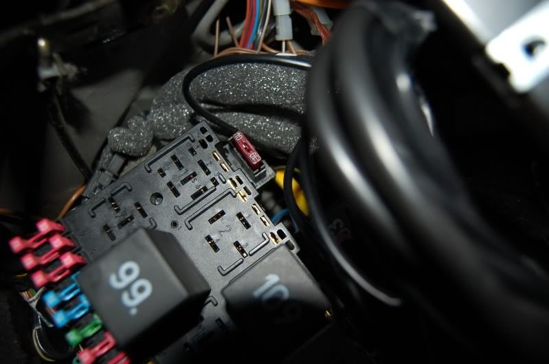

Mine doesn't have a relay nr 13 - or it's hidden somewhere, the nr 1 slot in the relay box is all empty :(

There is a connector attached to the radiator, which (in my car) is for a.c. clutch

you should deffo have a nr. 13 relay in there. make sure that you also have the a.c. fuse. The fact that you don't have that relay there, makes me think that one of the previous owners may have had some fuse blowing issues (maybe not) and removed the relay, so be careful and have ALWAYS a fire extinguisher next to you when you're working on wirings.. :nuts:
try to get a relay off a passat/golf/seat toledo etc and come back with fresh news so I can help you as much as I can :o

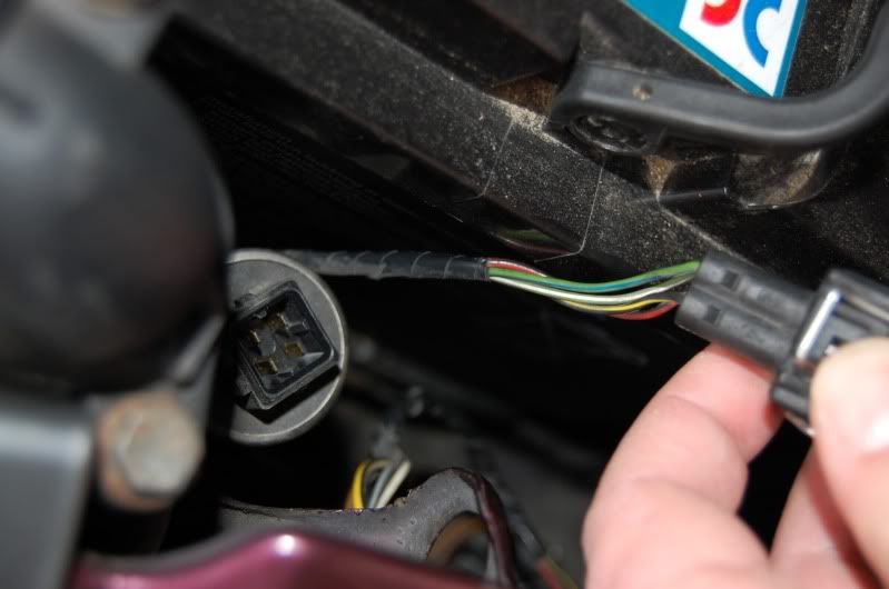

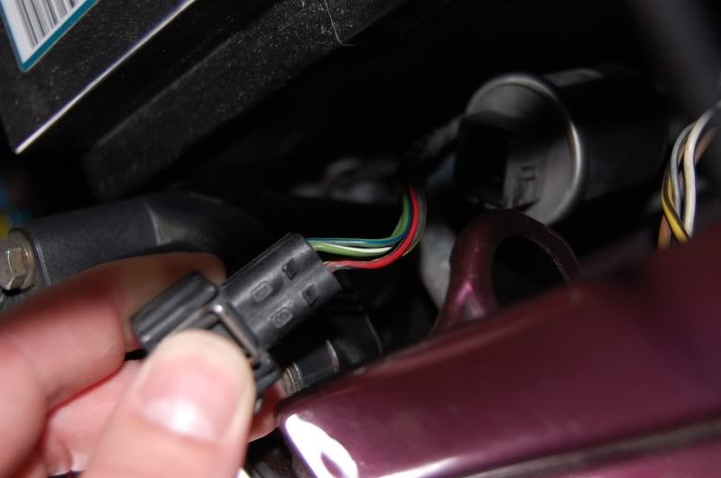

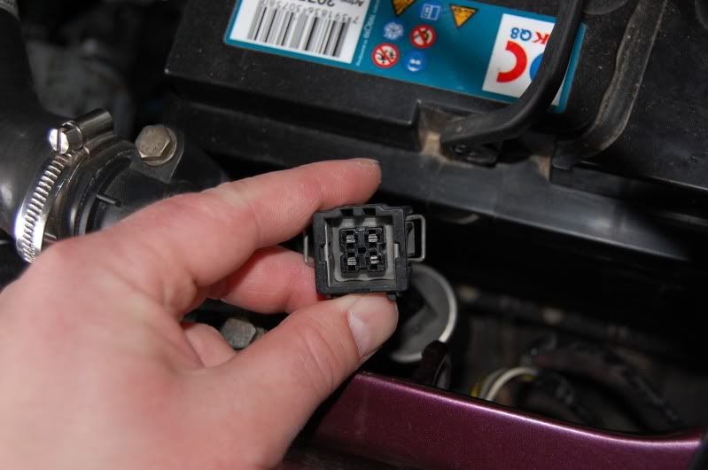

I found one having +12V - the black/yellow wire on the picture below:
the harness:
DSC_1606.jpg?t=1276696450
DSC_1608.jpg?t=1276696281
other side:
DSC_1609.jpg?t=1276696280
control switch:'
DSC_1607.jpg?t=1276696283
and the missing relay:
DSC_1614.jpg?t=1276696275

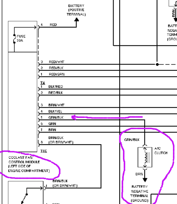

here is the reason why I was talking about fan control module - as the clutch seem to get it's 12V from the fan control module........just wondering if that might have the relay 13 "integrated" somwhow but I guess I'l just get hold of one and try.
cutout-1.png?t=1276697257

climatronic also needs info of the current coolant temperature in order to stop the a.c. compressor, and it's taken from the same wire you say as well.
I have been googleing for a picture of the relay 13 diagram, but I can't find it. It may be a "normal" double relay, but sorry I can't remember :(
well now, looking at the wiring diagrams you posted, I can see that the a.c. system on your car is really different from mine :( It has a lot of wires, while mine has only a few :nuts:

actually found that the switches inside seem to operate the harness on the control valve - I got +12V on one of the other wires as well when switch set to "norm" or "max" - the 2 still seem to be set to "ground"......
Realy not sure the wiring diagram is exactly the same as I have on the car - that's why I'm wondering if it might be controlled in the fan-control module (ie no relay 13)........I have to do some more research....:)
