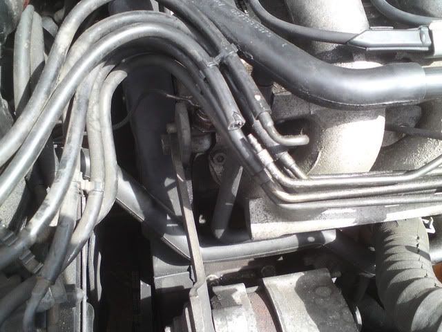

rubberdubber 0 Posted July 3, 2010 Hi all Have a problem, one of my flexible injector pipes was splitting where it connects onto the metel pipe so i stupidy thought it would just be a case of cutting the split bit out and pushing the pipe back on, or just replacing it with abit of fuel hose. However after removing it i have realised its solid plastic and it wasnt even split inb the 1st place it was just the outer rubber skin :brickwall: Anyhow, what can i do? I cant get the pipe back on, have tried heating it, opening it up all with no success. I have rang VW who have sold me a reel of the hose at great expense which is due in on wednesday but even when that arrvies im gona have the same problem of not being able to get it on! Anyone got any ideas? I take it the pressure is too high to use fuel hose or they would have done it in the 1st place. Alternatively if someone has a set of the pipes for sale? heres a picture of my horses arse behavior. Quote Share this post Link to post Share on other sites
mikkijayne 0 Posted July 5, 2010 Oops! There is up to 7 bar of pressure in those hoses, so normal fuel hose just won't cut it. If heating it up doesn't work I really don't know how you will get that new hose on yourself. That said, I have solved problems with these before by taking the ends to a hydraulic specialist such as Pirtek and having them swage a new hose on, so it might be worth taking your new piece of VW hose to them and seeing what they can do. Failing that, try and find someone breaking a 16V and buy a secondhand one (or set). :cat: Quote Share this post Link to post Share on other sites
davidwort 0 Posted July 5, 2010 need to find a second hand one I reckon a custom braided hose (which won't match the rest) isn't going to come cheap. there was a 16v bits for sale thread on here with a meteraing head with all lines attached for 30 quid, bear in mind 1.8 and 2L 16v lines have different fittings to the injectors though. Quote Share this post Link to post Share on other sites
Supercharged 2 Posted July 5, 2010 If your in a hurry go to Pirtek - not cheap but they'll be able to sort it Quote Share this post Link to post Share on other sites

Jim 2 Posted July 6, 2010 Your pic looks like it's a 9A (2.0 16v) - the injectors / lines are different between KR and 9A I believe :( Quote Share this post Link to post Share on other sites
rubberdubber 0 Posted July 6, 2010 im pritty certain its a 1.8kr unless someone has changed it in the past, only had it a few weeks but says 1.8kr on the log book and all looks factory under the bonnet. Thanks for the link swiftkid, i bought the metering head, pipes and injectors this morning that where advertised in the for sale bit. Cant wait for them to arrive, missing the rado! Quote Share this post Link to post Share on other sites
Kempy 0 Posted July 6, 2010 Your pic looks like it's a 9A (2.0 16v) - the injectors / lines are different between KR and 9A I believe :( they certainly are thats why mine are for sales Quote Share this post Link to post Share on other sites
rubberdubber 0 Posted July 6, 2010 So are we saying the picture of my engine bay looks like a 2.0? Quote Share this post Link to post Share on other sites
Kempy 0 Posted July 6, 2010 I cant tell... some of the uber geeks might :tongue: Quote Share this post Link to post Share on other sites
mikkijayne 0 Posted July 6, 2010 It looks just like my 1.8 KR to me :shrug: Quote Share this post Link to post Share on other sites
Wullie 1 Posted July 6, 2010 And mine. What looks different? Quote Share this post Link to post Share on other sites
