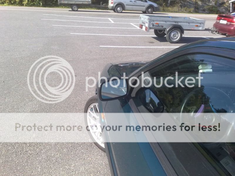

Picture from my car with them on..
Please don't mock the steering wheel. It's fixed now.. And the rims looks white from the sun/mobile camera.. :dorky:
That's just the job :clap:. Many thanks. They look like a good fit. It seems that the left hand side glass (part number ALG 230) may indeed be wide angle (see here:
