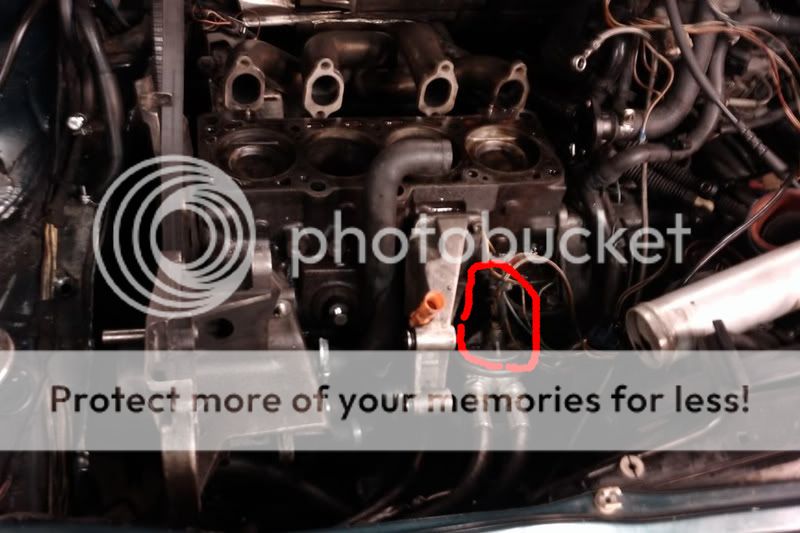

ive got a g60 lump in my caddy van, and i want to wire up an oil temp guage. i know they were fitted as standard on the corrado for the mfa, but dont know where it is??
is it the sender on the side of the head by the charger oil feed pipe??
It's the smallest of the two senders on the oil filter housing. Sorry for the horrible picture, but it's the only one I have atm.. :)
