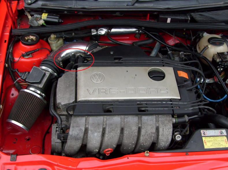

Hi, just wondering if anyone can give me the lowdown on this thing here:
Just wanna know what it is, what it does and what the part number might be?
Car's running a bit lumpy since I've discovered this pipe is split...
Thanks for any help, guys :]
its called a PCV valve - means Positive Crankcase Ventilation valve. These do tend to break due to the movement of teh engine as the mounts tend to wear. You could replace it with a piece of tube (like i ahve done), shoulndt make much of a performance difference. The rough running could be other things though.
Ive actually got some loose wiring there, one of the connectors is just hanging loose and im not sure where its supposed to go..lol i should i look into that!
