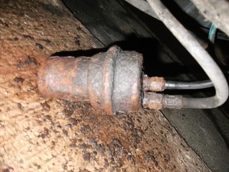

Big Adam 0 Posted November 4, 2010 Probably me bein thick, but whats this? its pissssssin fuel from it but not sure what it is :scratch: it came from behind where the two pipes cross if that helps?! as you can see its in a bad way n needs changin for the MOT :shrug: Quote Share this post Link to post Share on other sites
carrots 1 Posted November 4, 2010 could be some sort of filter :shrug: Quote Share this post Link to post Share on other sites
Jon_vr6 1 Posted November 4, 2010 Looks like its your accumulator check this link with pics http://www.the-corrado.net/.archive/forum/viewtopic.php?f=1&t=84116&p=973269&hilit=fuel+accumulator#p973269 Quote Share this post Link to post Share on other sites

Big Adam 0 Posted November 7, 2010 i know it was put there for a feason but whats its purpose? can you bypass it? Quote Share this post Link to post Share on other sites
CorradoVR6-Turbo 0 Posted November 7, 2010 google. Fuel accumulator The fuel accumulator maintains the pressure in the fuel system for a certain time after the engine has been switched off. When the engine is running it serves to deaden the noise of the electric fuel pump. After the engine has been switched off, the fuel accumulator maintains the pressure in the fuel system in order to facilitate re-starting, particularly when the engine is hot. The design of the accumulator housing is such that it deadens the noise from the fuel pump when the engine is running. The interior of the fuel accumulator is divided into two chambers by means of a diaphragm. One chamber serves as the accumulator volume for the fuel, the other chamber contains a spring. During operation the accumulator chamber is filled with fuel. This causes the diaphragm to bend back against the force of the spring until it is halted by the stops in the spring chamber. The diaphragm remains in this position, which corresponds to the maximum accumulator volume, as long as the engine is running. Quote Share this post Link to post Share on other sites
aide 0 Posted November 7, 2010 /\ + the membrane ruptures with age, which lessens its performance somewhat :) Quote Share this post Link to post Share on other sites
