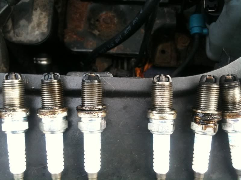

raddo-dave 0 Posted November 14, 2010 ok i have been and bought some bkr6e plugs this morning but i dont have access to a feeler gauge till tomorrow, i have put them in anyway just to see if it gets better and it didnt do anything these are the plugs i took out the four on the left were all wet and the two on the right were dry and sooted up(these were from the 2 front cylinders on the right) thanks for all the replys guys its much appreciated dave Quote Share this post Link to post Share on other sites
CorradoVR6-Turbo 0 Posted November 14, 2010 thats poor,you say you have swaped the leads and coilpack over? the plugs that are wet,does it smell of fuel or oil? Quote Share this post Link to post Share on other sites
raddo-dave 0 Posted November 14, 2010 fuel yeah i swapped the leads and coilpack over from my other vr6 i use daily Quote Share this post Link to post Share on other sites
CorradoVR6-Turbo 0 Posted November 14, 2010 is there any sign on the plugs you took out of fine like pencil lines on the ceramic of the plugs? just need to 100% make sure its not the leads or coil pack breaking down,i know they are off your daily but once forced induction comes into play cylinder pressures are much higher and you need much stronger spark. If all that fails i would look into the mapping side of things,what fuel pressure do you run? standard 3.5? Quote Share this post Link to post Share on other sites
raddo-dave 0 Posted November 14, 2010 when u say pencil lines do u mean like a hair lin fracture? its got a 4 bar fuel reg Quote Share this post Link to post Share on other sites
