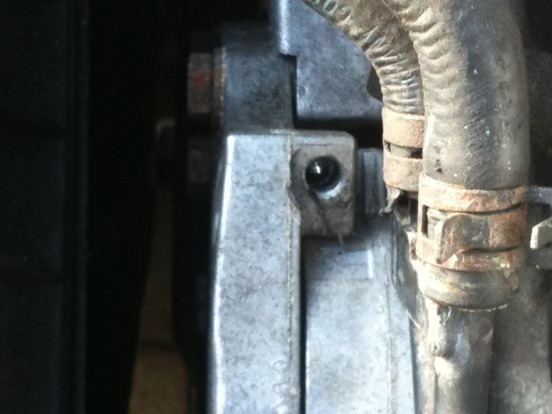

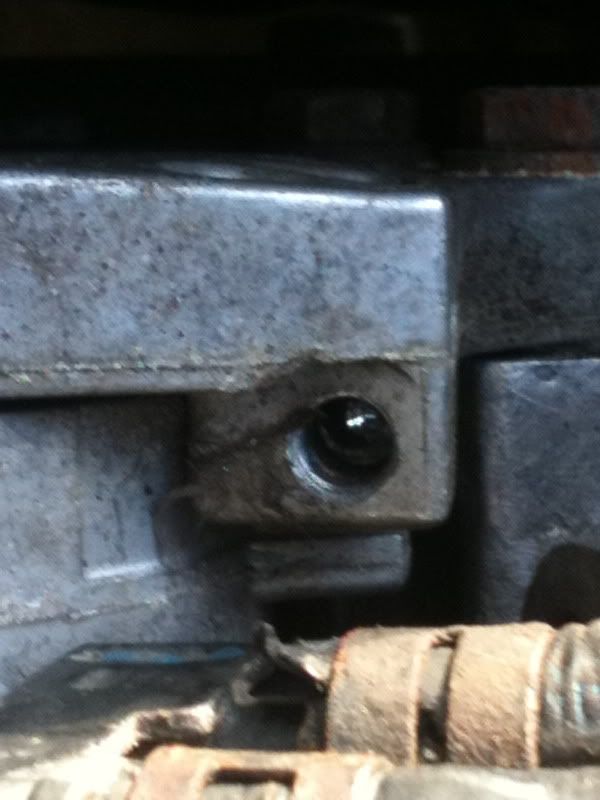

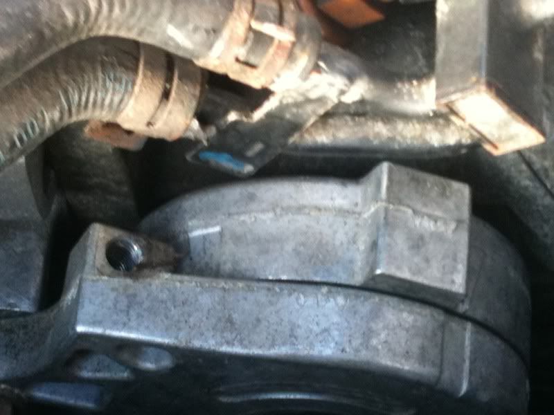

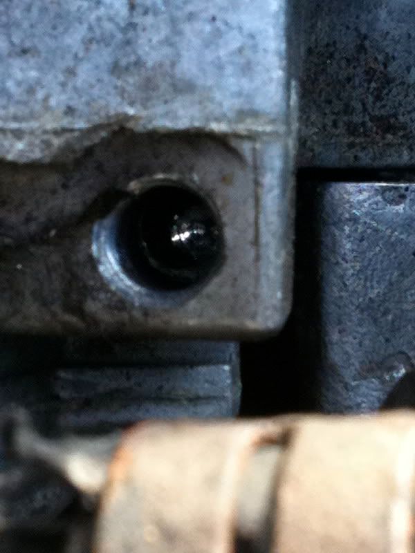

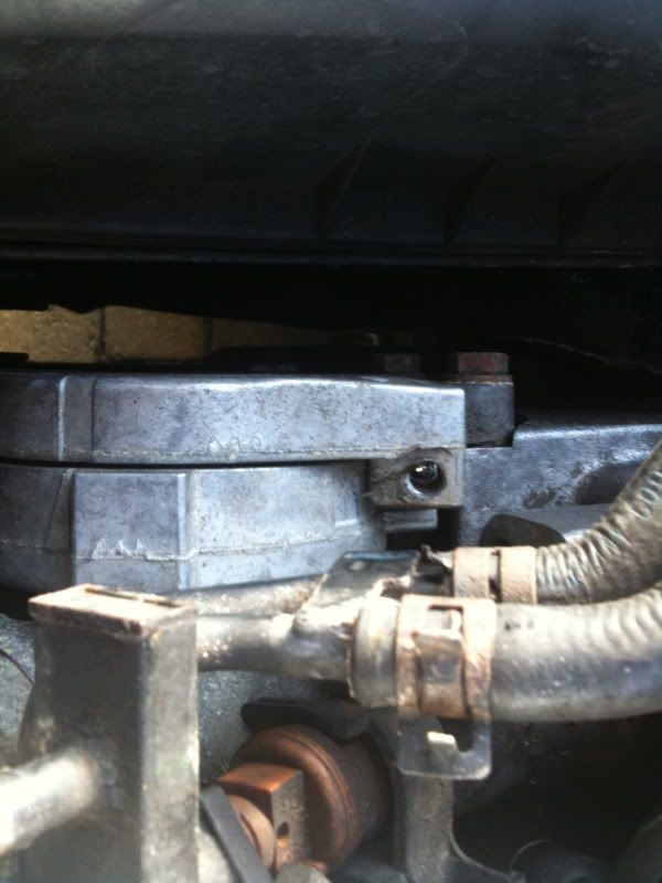

krishen 2 Posted December 5, 2010 Am i missing a bolt here? It looks like it may have snapped. This is the bit in the pic above where you are using a long bolt (red arrow) http://i85.photobucket.com/albums/k59/k ... G_0436.jpg http://i85.photobucket.com/albums/k59/k ... G_0435.jpg http://i85.photobucket.com/albums/k59/k ... G_0434.jpg http://i85.photobucket.com/albums/k59/k ... G_0433.jpg http://i85.photobucket.com/albums/k59/k ... G_0432.jpg Quote Share this post Link to post Share on other sites
dr_mat 0 Posted December 5, 2010 There is not *supposed* to be a bolt there. You insert a bolt in order to take the tension off the belt so you can remove it. RW1 must have taken the picture in the middle of working on it ... Quote Share this post Link to post Share on other sites
RW1 0 Posted December 5, 2010 Correct dr_mat, while doing the water pump. Hadn't thought someone would look at it that way :lol: I'll have to "improve" my instructions in future. I did say available from B&Q! . Quote Share this post Link to post Share on other sites
