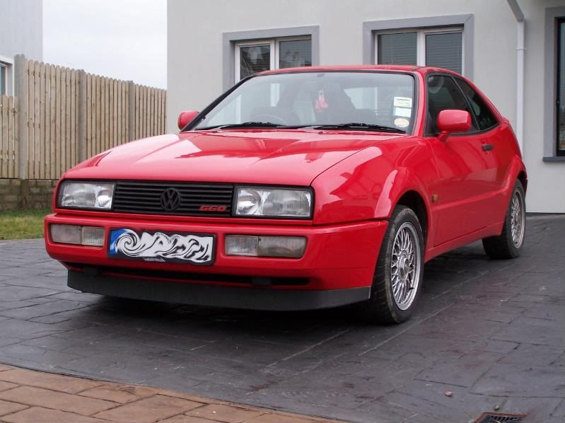

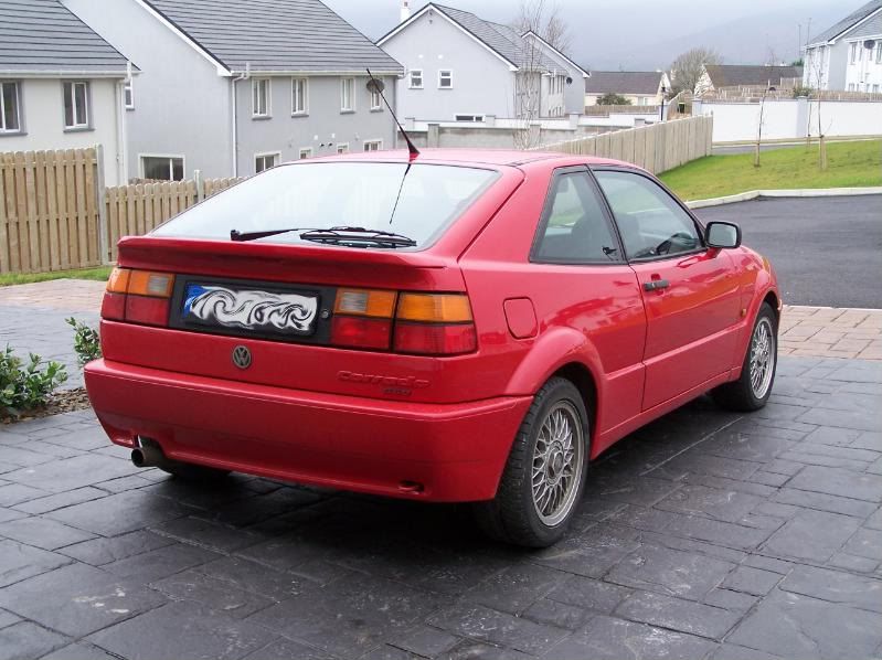

A little about the car.....

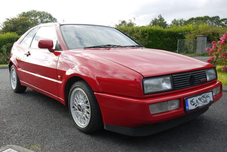

It's a 1991 (J Reg) G60 which arrived in the country a few years ago.
It has relatively low and verifiable mileage at just a little over 86k miles. In fact the car only had notched up just 10k miles within it's first 10 years of life. The then owner apparently had a few cars and literally did a couple of k per year. It currently sits on a fresh NCT until 2012.

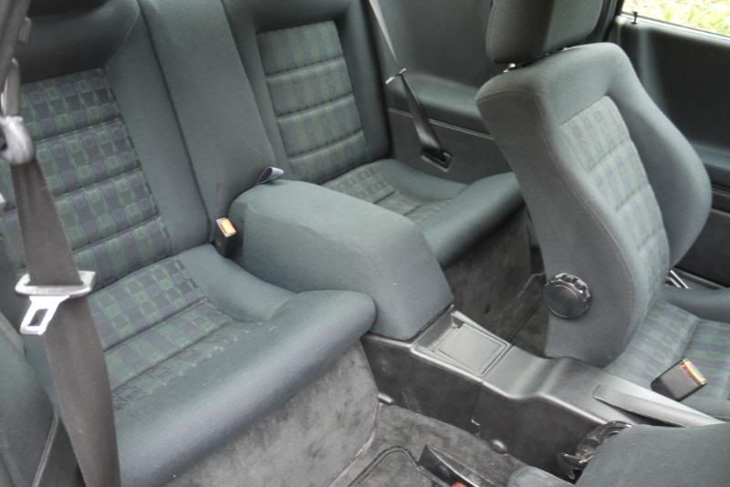

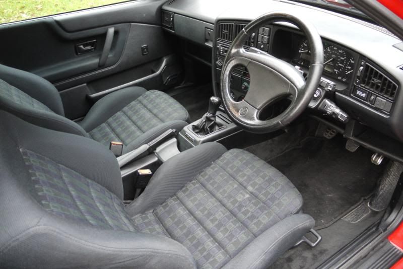

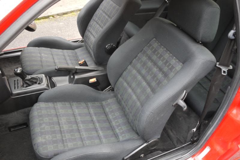

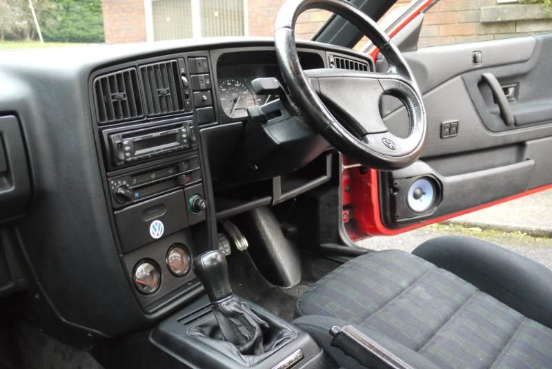

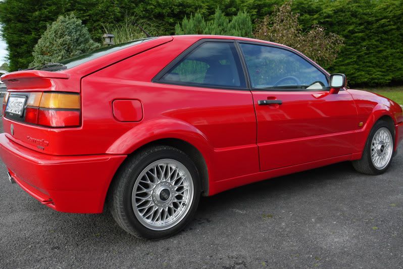

The interior of the car is genuinely immaculate with the only a missing cover from the drivers speaker in the door. Rear seats look as if they got little or no use at all. Similarly the boot area looks factory above and beneath the boot carpet.

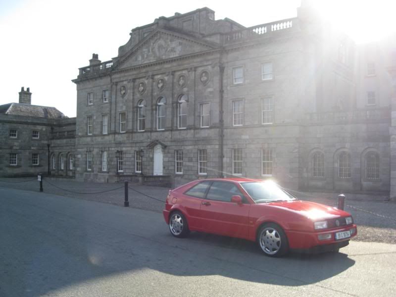

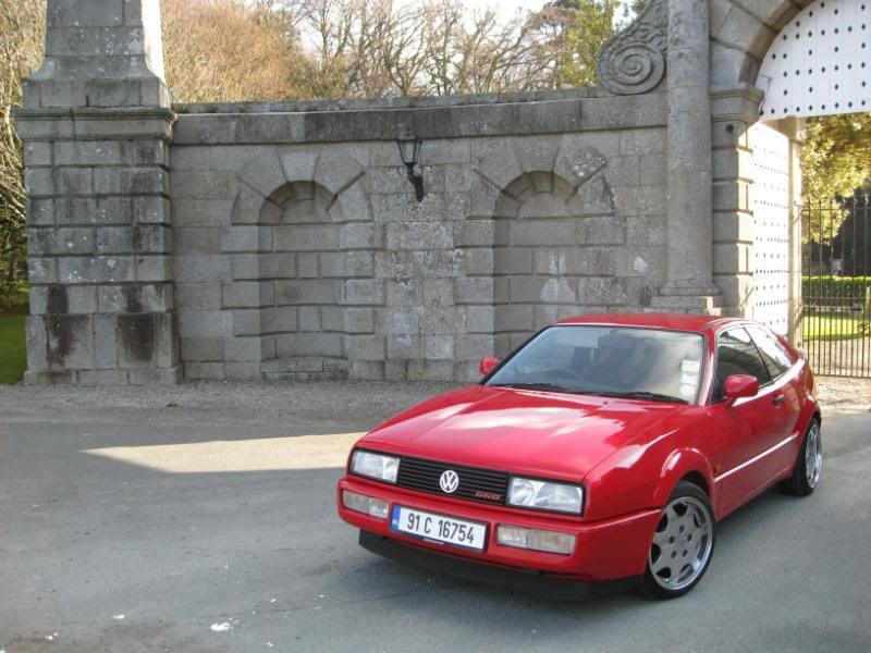

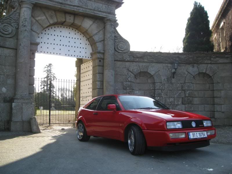

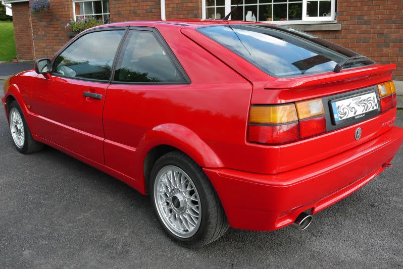

Outside, the car did get a respray since it arrival in Ireland so bar a good detail it has zero rust anywhere on the car including arches and floor and thankfully no parking dings etc. The original Corrado wheels are fitted and were freshly refurbed. I have very few pics at the moment due to the snow but here are a couple to give you an initial idea of condition.
Also, delighted that the sun roof both tilt and slides which is a plus when buying a Corrado.
Note: pics are before H&R kit, refurbed wheels and new exhaust was fitted.

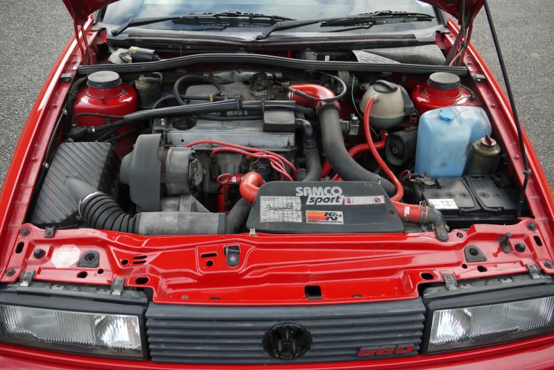

Engine and mechanicals:

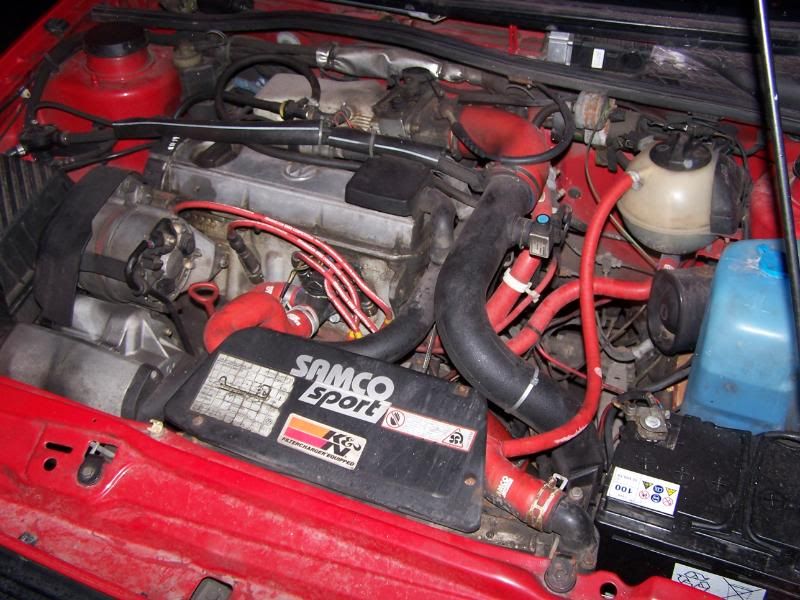

The car has been well looked after as proven by the file with the car. Any changes have been of the OE+ variety. The most notable items in engine bay is a set of samco, a new charger from GWerks, Magnecor leads and a K&N filter.
The last owner fitted a new Jetex stainless exhaust system and also a H&R suspension cup kit so it handles very well and sounds good too.

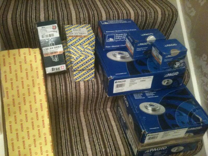

Brakes:
The car is to get a complete brake overhaul.
Plan is to replace:
Master cylinder
Brake regulator
Discs front and rear - Pagid
Pads front and rear - Pagid
Fit Goodridge braided lines
Fresh brake fluid
As pictured above, new bearings front and rear too and a fresh set of wipers.

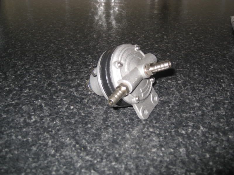

Also from Bartek, a 4.7 bar variable fuel pressure regulator (FPR)
Along with VA Adaptor, alloy Pipe, VW O-ring Kit, pressure hose, clamps and adjusting key.

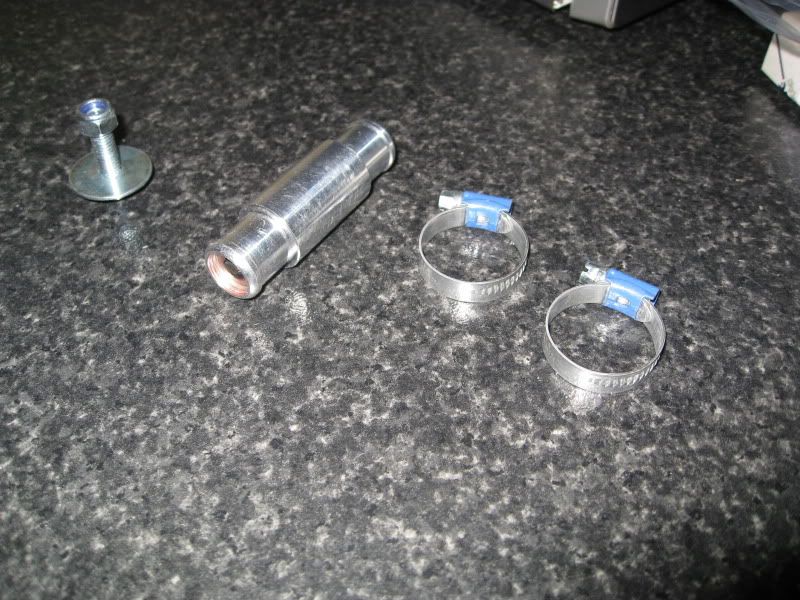

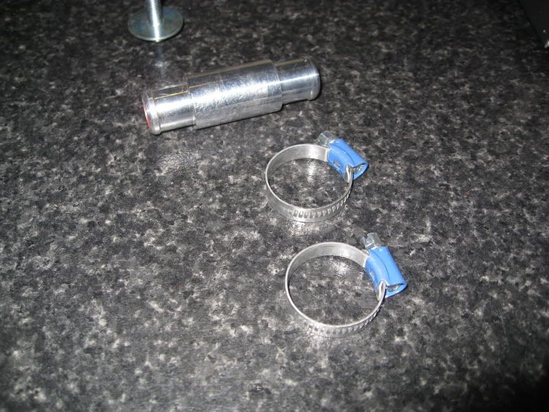

Bartek RS bypass valve and clamps. This valve increases boost at higher revs.

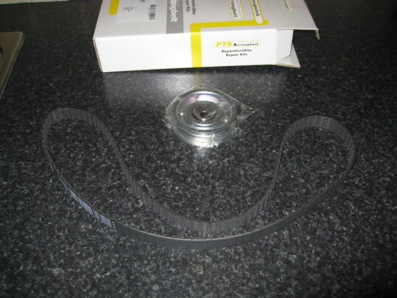

Although it had a cam belt and tensioner not too long ago, I decided to refresh it again

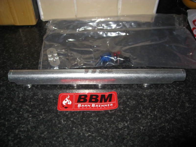

Next few come from Bahnbrenner:
Starting with G60 fuel rail and kit

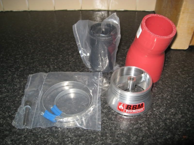

G60 RSR outlet kit:

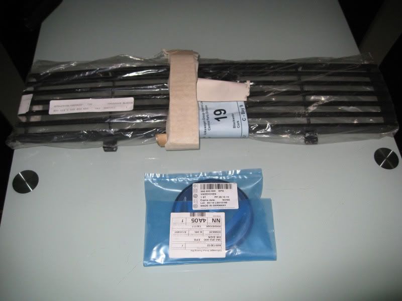

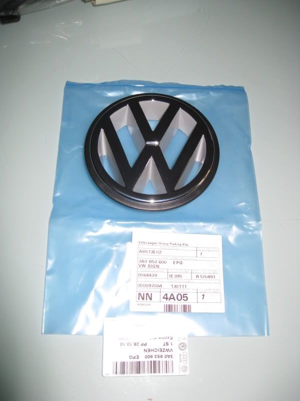

Fresh grille and chrome front badge

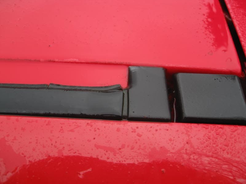

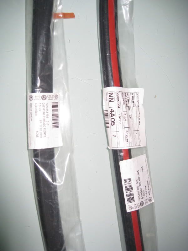

Roof rails were getting a bit tired looking so thought best to replace them while still available
Previous stereo left it's scars. Just need to remove lower plastic which contains the large Sony controller and fit the new one

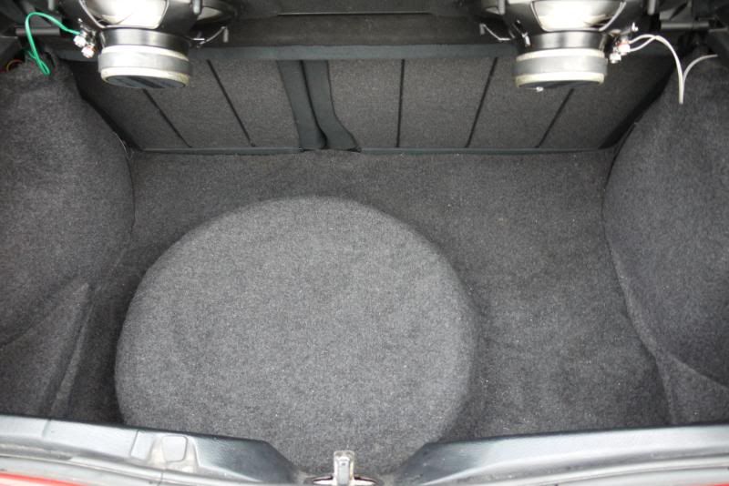

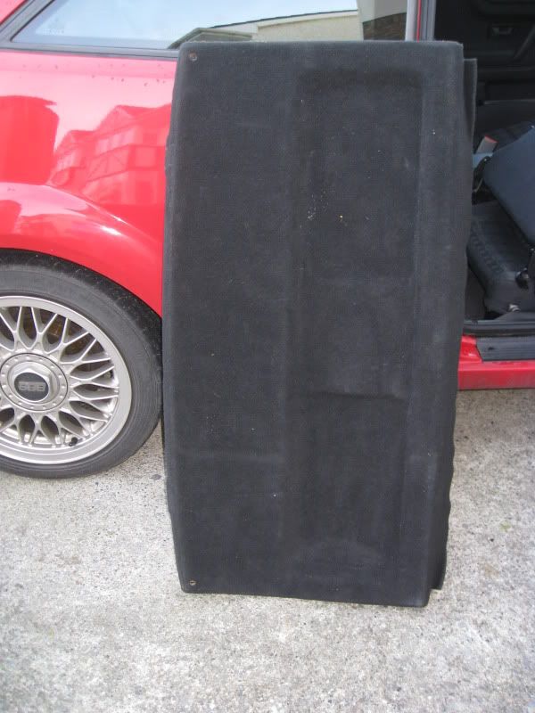

Rear shelf loaded with two nice but heavy speakers so out they will be coming and this slotted in

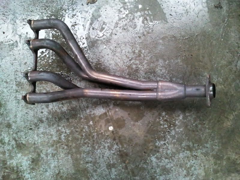

I spotted this 4 branch MK2 8v Milltek manifold for sale so while not 100% on fitment we're going to give it a go. The car came with a new Jetex stainless system so should be a nice combination.

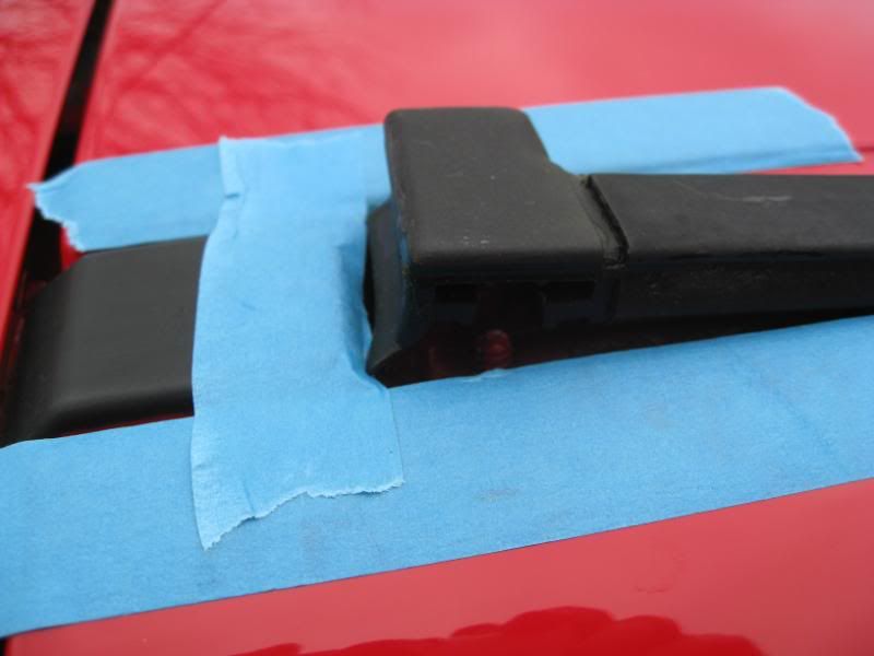

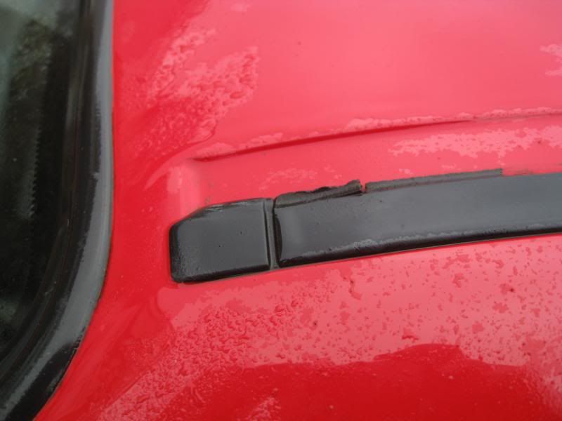

I started some of the body trim jobs.

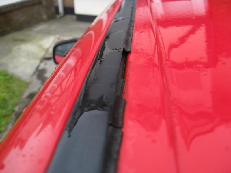

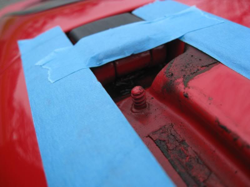

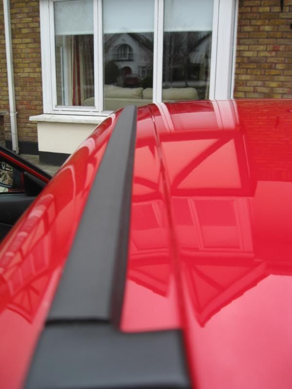

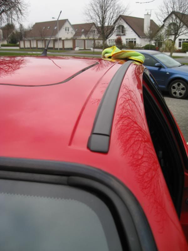

First up roof rubbers/rails (before and after).

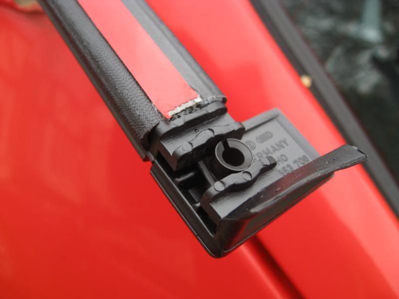

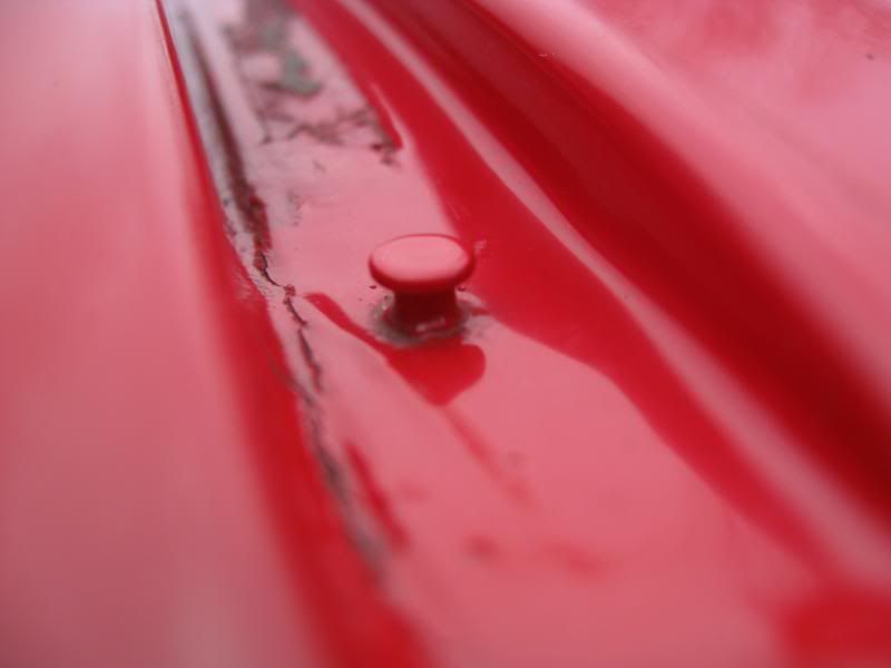

Note: to remove rail you start at the back. I taped up th surrounding area and using a small plastic lever lift the cap gently. It is secured by a bolt like pin. Once lifted, gently lift the rail which is stuck down in the groove with a sticky tape. When you get near the front gently pull the front cap backwards off the pin that secures it. Give the groove a good clean before fitting new ones.
Fitting is the reverse. Slide front cap into place, pull back tape cover, and gently push rail down into groove with palm of your hand. When you get towards the back align plastic cap with gripper and push into place. Pics should explain a lot of this.
Before:
Back
Front
After:

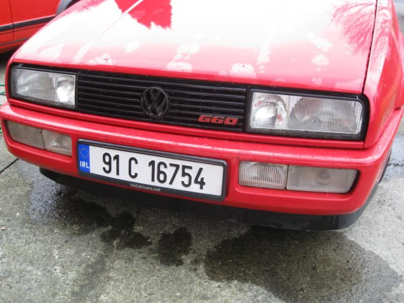

Front grille and badge replaced also.
Before:
After:

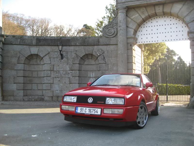

Finally, first real pics I took of the car myself...
