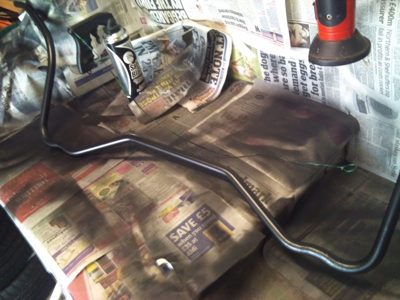

Jim Bowen 1 Posted June 6, 2012 been searching for this answer today, found my old pics, thought i'd share in case it helps anyone out. pic i took when subframe was removed the same arb before being fitted. not worked it out yet though Quote Share this post Link to post Share on other sites
