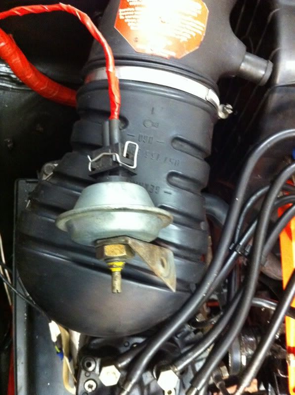

RowanVW 0 Posted March 2, 2011 Anyone know what this part is for? Thanks Quote Share this post Link to post Share on other sites
gonzo 0 Posted March 2, 2011 what model corrado is it Quote Share this post Link to post Share on other sites
hyland770 0 Posted March 2, 2011 c'mon man you can see the k-jet right there its a 16v!!! Quote Share this post Link to post Share on other sites
davidwort 0 Posted March 2, 2011 Diaphram pressure switch, part of the idle and overrun vacuum system Quote Share this post Link to post Share on other sites
RowanVW 0 Posted March 2, 2011 Aaaah, thank you! I can now search and see where too fit it into the system! Quote Share this post Link to post Share on other sites
Wullie 1 Posted March 2, 2011 It goes here, bolts to the rear of the air flow meter. The vacuum line connects to a three way connector just behind the air box. [ATTACH=CONFIG]44998[/ATTACH] Quote Share this post Link to post Share on other sites
