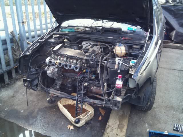

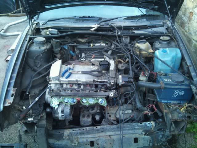

Co-Pang-Yang 10 Posted May 17, 2011 Hello again. Well my Landy's oil pump deciding to fail and wreck my engine on the way to the MOT last month caused issues and resulted in all my spare time being taking up with fixing that. Its finally on the road and orthough it still needs work it does allow me a bit of free time to start on the Corrado. Still haven't got any proper daylight pics yet. Had a bit of time yesterday so started stripping it down: Firstly I need to find out excatly what I have. It runs a Dizzy as aposed to the Golf engine which was coil pack. My original plan was to get the Golf's head skimmed maybe change the valves (any suggestions on what to have done?) then whip the Corrado's head off and fit the Golf. But now I'm assuming this won't work as one is coil and one is dizzy. Been reading through some guides on changing the timing chain, should I bother? If so how much are the parts going to cost? Gonna have a lot of questions so please try and bare with me, my mechnical skills are pretty basic (hense why I have a 20 year old Land Rover diesel lol) Cheers Chris Quote Share this post Link to post Share on other sites

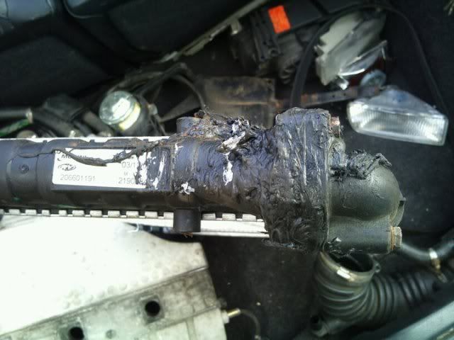

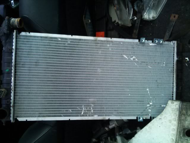

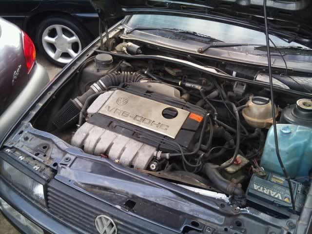

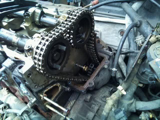

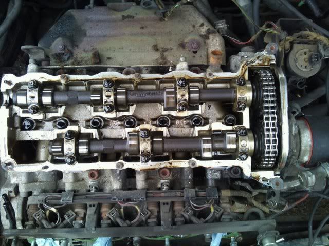

Co-Pang-Yang 10 Posted May 17, 2011 Took a couple more shots today: No rot but plenty of scuffs and dents 16v rad? Not nice Fortuanlly this is in good nick Not a fan of the grey dash though Early bonnet As far as I got with the engine, didn't realise that the cam sprokets have to come off to remove the chain. Gonna have to bring a bigger spanner with me to hold the cam in place whilst I undo the nut. Quote Share this post Link to post Share on other sites

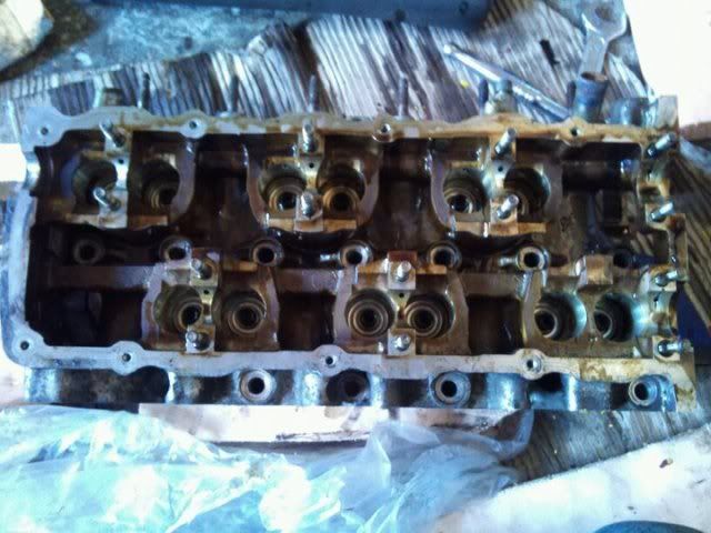

Co-Pang-Yang 10 Posted May 18, 2011 Anyone got any suggestions on what to have done with the head if i'm having it skimmed and how much to expect to pay? Quote Share this post Link to post Share on other sites
VW_OwneR_85 2 Posted May 18, 2011 fair play m8, i brought a a cheapy a few months back, looking back i would of rather paid abit more for one thats in better condition but at the time i realy wanted one and i couldnt afford paying much more,got loads of little bits to sort out. if your playing with the chains you should invest in this cam locking tool,http://cgi.ebay.co.uk/VR6-Camshaft-Alignment-Engine-Repair-3268-Cam-Tool-VW-/170620273753?pt=UK_CarsParts_Vehicles_CarParts_SM&hash=item27b9c2c459 Quote Share this post Link to post Share on other sites
Co-Pang-Yang 10 Posted May 19, 2011 Yer can see the advantage of buying to good one lol. Ended up making a locking tool so got that covered. Next job I have to do is to remove one of the cam sprokets so I can get the chain off. Just hope I don't brake anything. Quote Share this post Link to post Share on other sites

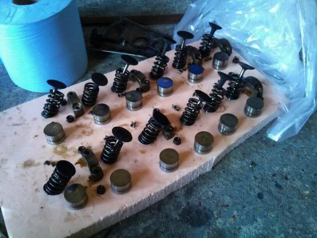

aide 0 Posted May 19, 2011 as a guide i paid £125 quid to have a head cleaned, skimmed, new valve guides pressed in, valve seats reground and valves refaced. i provided the new valve guides to the engineering shop, they were about £35 for 12. the dizzy and coil pack heads are the same, just a blanking rubber needed where the distributor shank goes. you'll never undo the cam gears from the cam in situ, just loosen the cams and untension the top tensioner and unhook the chain that way. and plenty of us buy projects, good work and keep the faith :) Quote Share this post Link to post Share on other sites
Co-Pang-Yang 10 Posted May 19, 2011 Thanks very much for the info mate, I'll start phoning round some local engine builders and see what prices I can get.Don't suppose you still have the link to where you got the new valve guides from do you? Ok handy to know that I can use the Golfs coil pack head then. And thanks I'll have a go at removing the cam next week instead and then I will be able to see whats what in the engine. Ha ha I will try, would much prefer to put it on the road and use it as a fun summer toy! Quote Share this post Link to post Share on other sites

Co-Pang-Yang 10 Posted May 24, 2011 as a guide i paid £125 quid to have a head cleaned, skimmed, new valve guides pressed in, valve seats reground and valves refaced. i provided the new valve guides to the engineering shop, they were about £35 for 12. Done well with your price mate. Best quote I have is £150 for skim, seats re-ground and valves re-faced. Plus £11 each to supply and fit new valve guides. Quote Share this post Link to post Share on other sites
aide 0 Posted May 24, 2011 yeh seems i did, i was surprised at the time it wasn't more, but then Northern Ireland would be cheaper than the UK for some things. Quote Share this post Link to post Share on other sites
Co-Pang-Yang 10 Posted May 24, 2011 Ah true I suppose. Having a chat with the engineer he said they get a lot of older VW engines in and usually the valve guides are fine or at worse just the exhaust side need changing. I noticed a little play in the exhaust side and none on the inlet side. There gonna check them for me and let me know what they would recomend. Would love to get it ported and polished at the same time but reckon we're talking at least another £200 and I'm too skint for that lol. ---------- Post added at 09:27 AM ---------- Previous post was at 09:25 AM ---------- Stripped the Golf head down yesterday ready to take to the machine shop: Valves look straight but will have them checked to make sure and lifters don't appear to be warn so thats good. ---------- Post added at 10:28 AM ---------- Previous post was at 09:27 AM ---------- Also should a VR6 fan be single or twin? Quote Share this post Link to post Share on other sites
aide 0 Posted May 24, 2011 yeh same there was a lot more play in my exhaust side, but at cold they'll feel more wobbly because the stem of the exhaust valve is something like .02mm thinner to allow for greater expansion. ref p&p ingfrom what i've heard bigger valves is where the real benefit is, so just figured i'll save for some force feeding instead as big valve heads are serious money :) vr6 should be twin fan, one motor drive the other belt. you ought to get one of the mods to relocate this thread into the members gallery, i think they auto delete from this folder if there's inactivity. Quote Share this post Link to post Share on other sites
