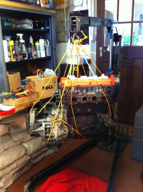

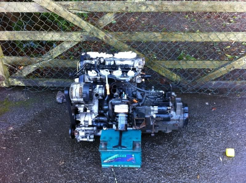

RowanVW 0 Posted April 29, 2011 As far as i can tell this is rarely done and i am yet to find a completed example by using the search function, most people put the KR head and Kjet on an ABF bottom end, but because my loom has been ruined i cant do this. I have absolutely everything from the donor MK3 including engine, mounts, full loom, key, barrel and immoboliser etc. What problems am I likely to run into? not including the clearance on the bonnet issue! Will update this tommorow as i start the conversion! Quote Share this post Link to post Share on other sites

RowanVW 0 Posted May 2, 2011 Haha I will buy one when i get the chance! Yeah I couldn't find a clear cut example of it done on this forum, but its done on mk2 golfs quite alot! Should be great if i get it sorted! The engine is in now, just need service it and sort out the loom! Anyone who is interested in this, i swapped the front mount off the KR and the rear bracket from the block and kept the same mounts on the chassis, and the gearbox mounting doesn't need changing at all. Fairly straightforward! Quote Share this post Link to post Share on other sites

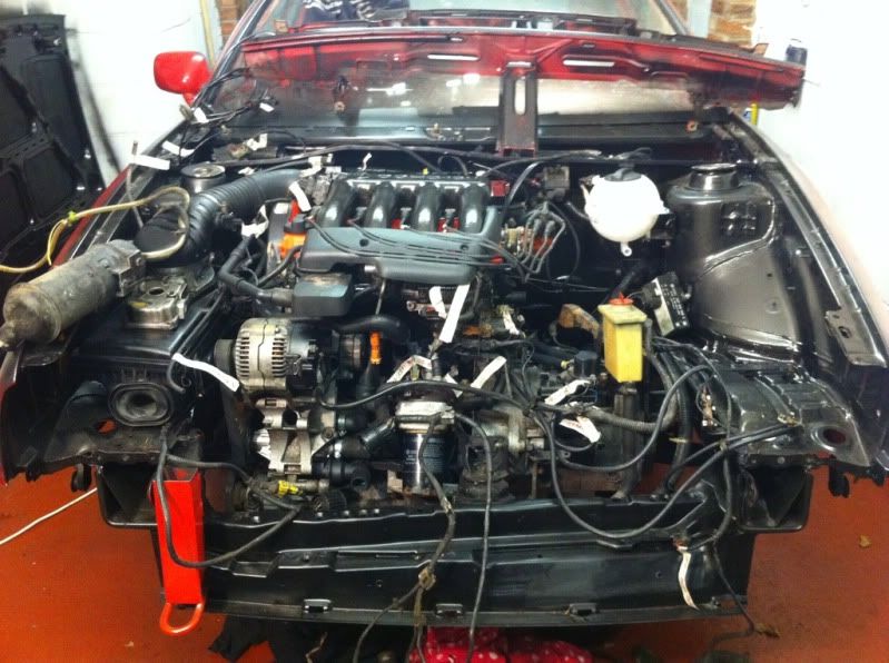

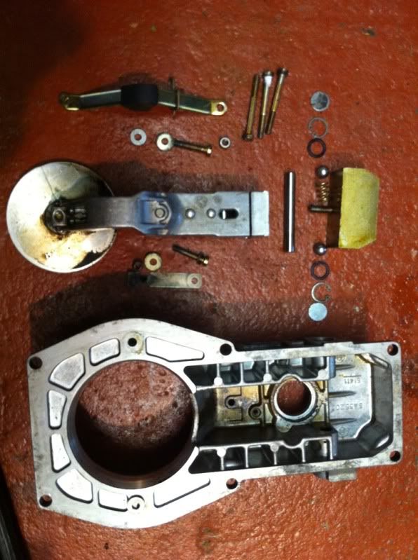

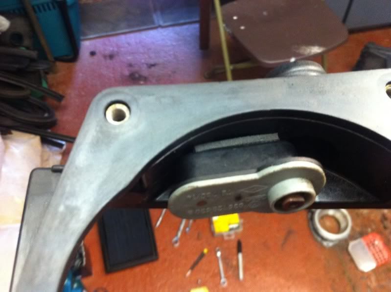

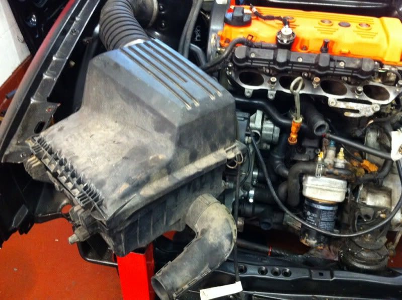

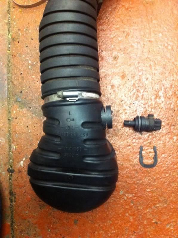

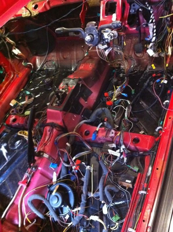

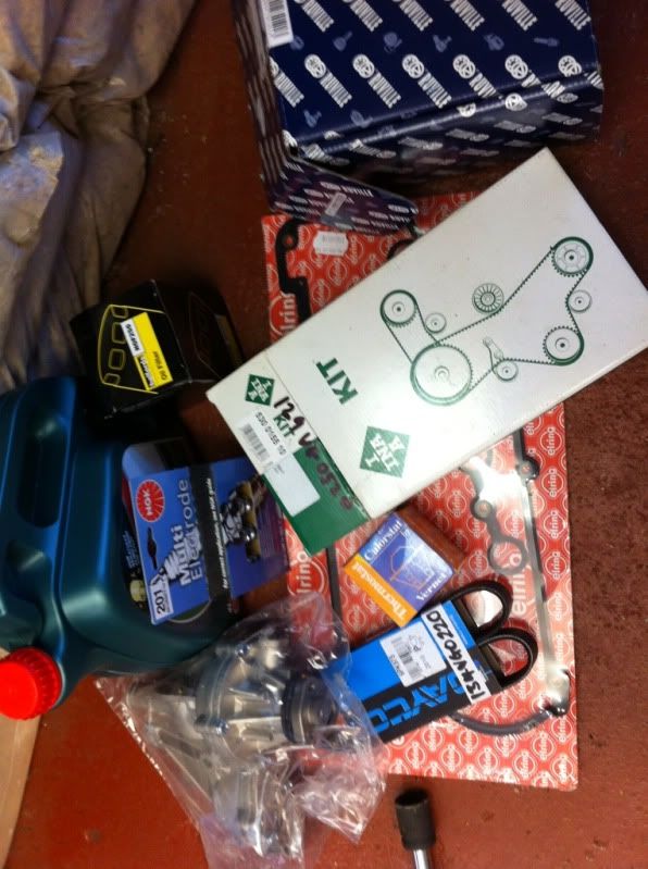

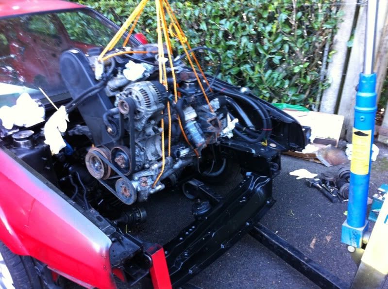

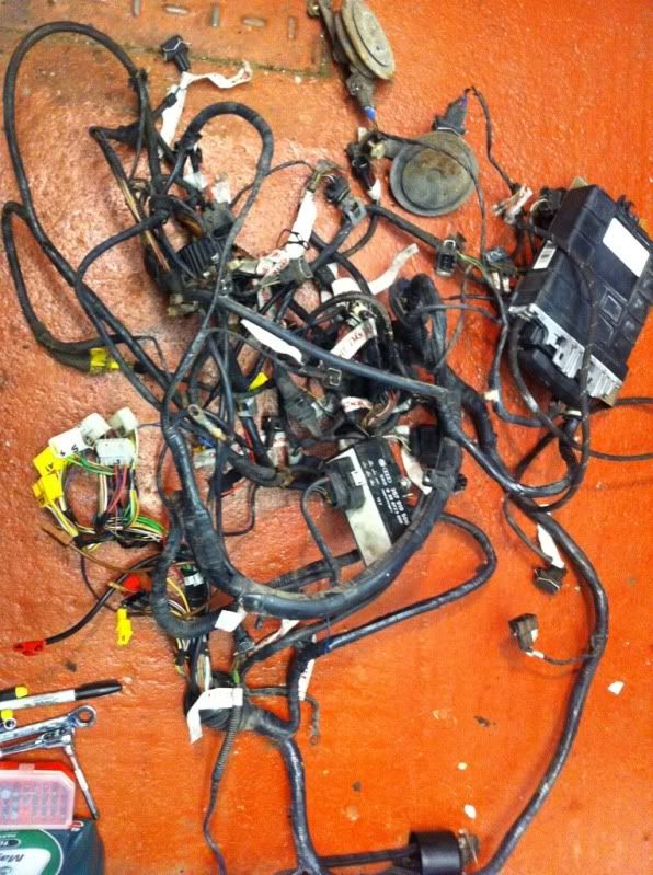

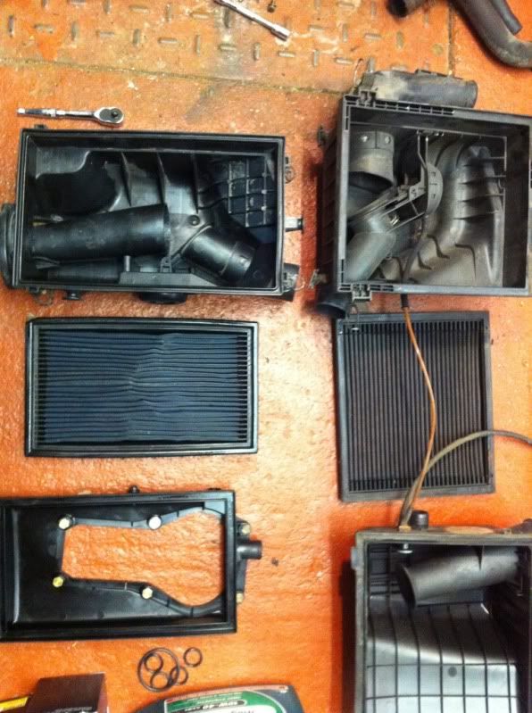

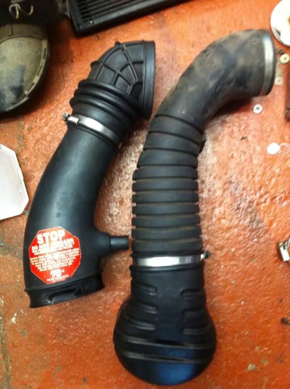

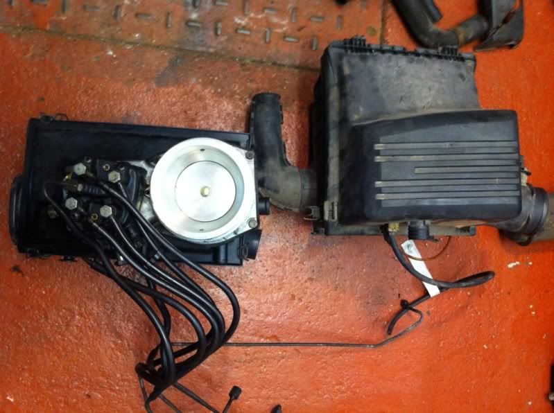

RowanVW 0 Posted May 5, 2011 (edited) Update: Gave the engine a service first which was straightforward apart from the slight difference between the ABF and KR crank pulleys which is one to look out for when doing timing belts Also i have had to take the whole sump off and buy a new one, the bolt was rounded, all the usual tricks WD40, heat, hammering a small socket on and molegrips + hammer have failed, i even tried turning the whole sump around the bolt in a vice; no joy! Anyway, had to work something out for the airbox as the Golf MK3 one is huge! So by combining parts from both to get the warm air at start up system and air flow meter in I had to do some minor fabricating and it all fits quite well! All of the wiring is in one loom which is nice compared to the Corrado but slipping it down the small gap round the back of the brake servo takes some patience even with the servo loosened completely. So all of the wiring is in at the front and I am currently working the headlights into the ABF loom, I have also used the Golf GTI indicator stalks which are plug and play! Hope to get it started and finish getting the interior loom sorted, when I next get some free time from work and uni! :) Edited May 9, 2011 by RowanVW Quote Share this post Link to post Share on other sites

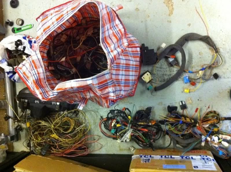

RowanVW 0 Posted May 11, 2011 Update as much for my own reference as other peoples: So with two looms and one fusebox here is whats being kept from what: A1 - ABF - Left light harness A2 - ABF - Right light harness B - N/A Headlight washers C - ABF - Engine wiring and fluid sensors D - KR - Heated wing mirrors E - ABF - Instrument and immobiliser circuit + brake sensor F - ABF - Engine management G1 - ABF - Engine management G2 - ABF - Engine management H1 - ABF - Column harness H2 - ABF - Column harness J - ABF - Column Harness K - KR - Rear wiring harness L - KR - Interior harness M - KR - Fuel harness N - N/A - Air con P - KR - Fogs and heated rear windscreen Q - ABF - Dash misc, lighter and heated motor R - KR - Light switch S - ABF Wipers T - N/A - Euro harness U1 - ABF - Instrument cluster U2 - ABF - instrument cluster V - ABF - MFA W - N/A - ABS X - N/A - Extra warning lights ABS and Airbags Y - Y4 - ABF, Battery Power 30 - Fuel power Z1 - N/A glow plugs 30B - Fuel power Z2 - ABF - battery ground Fusebox - 1 N/A Air Con 2 Rear wiper relay - 72 3 Motronic - 30 4 Load reduction relay - 18 5 Low coolant control - 43 6 Flashers - 21 7 N/A - headlight washers 8 Wash/Wipers - 99 9 N/A - seatbelt warning 10 Fogs - 53 11 Horn - 53 12 Fuel pump relay - 167 So now i just need to tidy the inevitable odd few loose wires and should hopefully start it/ test the loom over the weekend! For those who agree a picture says a thousand words: The situation inside Just part of the leftover wiring Quote Share this post Link to post Share on other sites

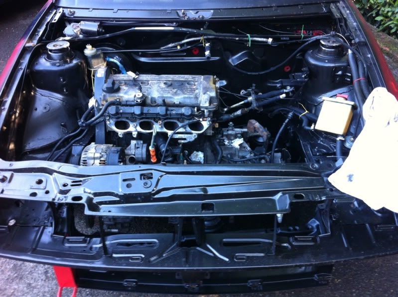

boost monkey 0 Posted May 11, 2011 Really liking the black engine bay, very functional! what colour is the rocker cover? it looks ASBO orange Quote Share this post Link to post Share on other sites
RowanVW 0 Posted May 11, 2011 Haha cheers, I admit many won't like it so far but the overall finished product should be good, black with anthracite wheels im thinking and red detailing. The colour is actually VHT red paint! makes a nice contrast i think! Quote Share this post Link to post Share on other sites

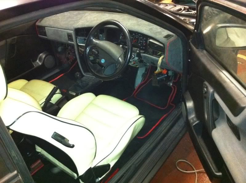

RowanVW 0 Posted July 15, 2011 Car has been pretty much finished, passed MOT today, feels fantastic to drive :) Loving it Quote Share this post Link to post Share on other sites

RowanVW 0 Posted July 25, 2011 Cheers, yeah I know but the car didn't come with a dash or interior, would have been scrapped If I didn't sort it I reckon! Quote Share this post Link to post Share on other sites
