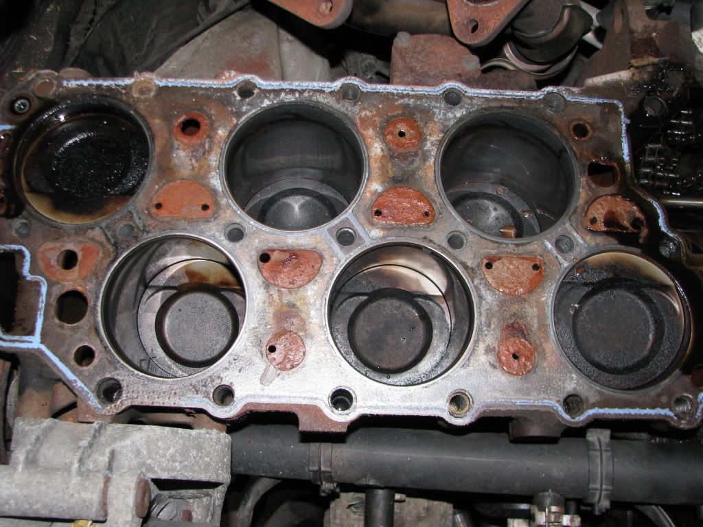

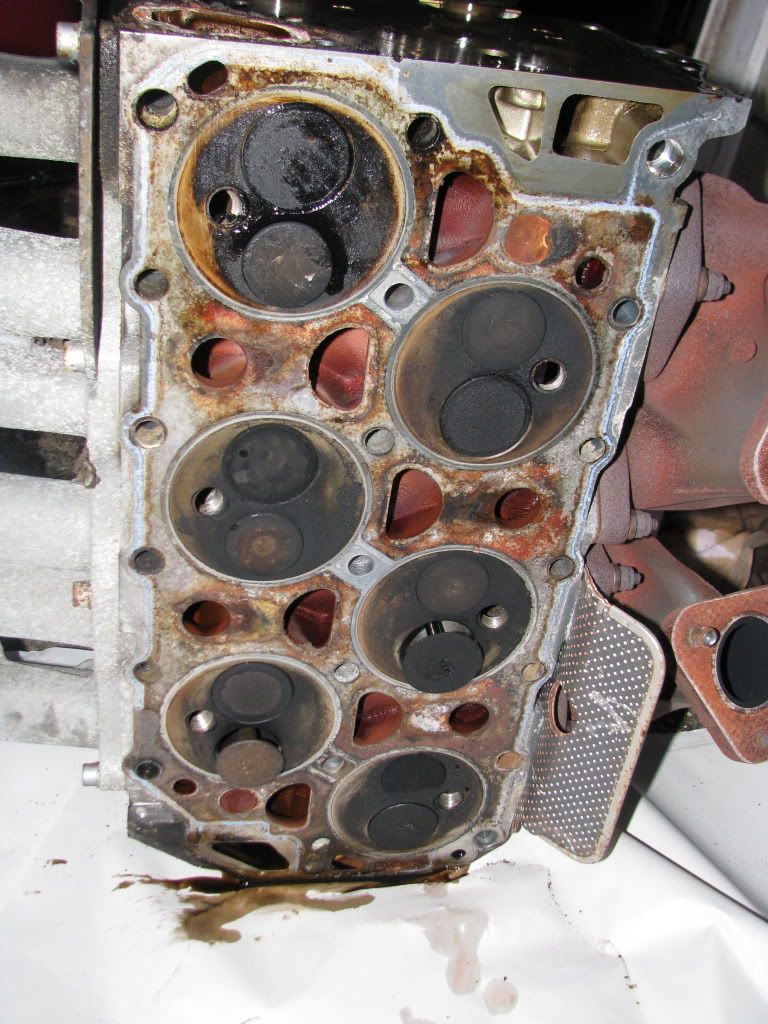

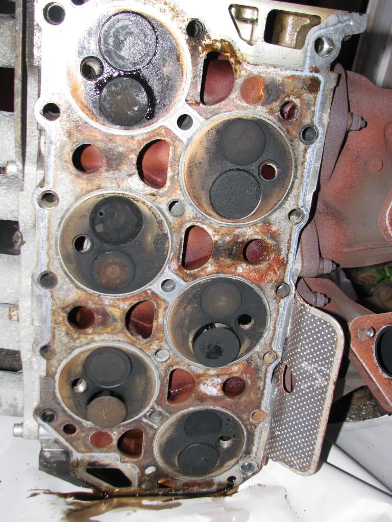

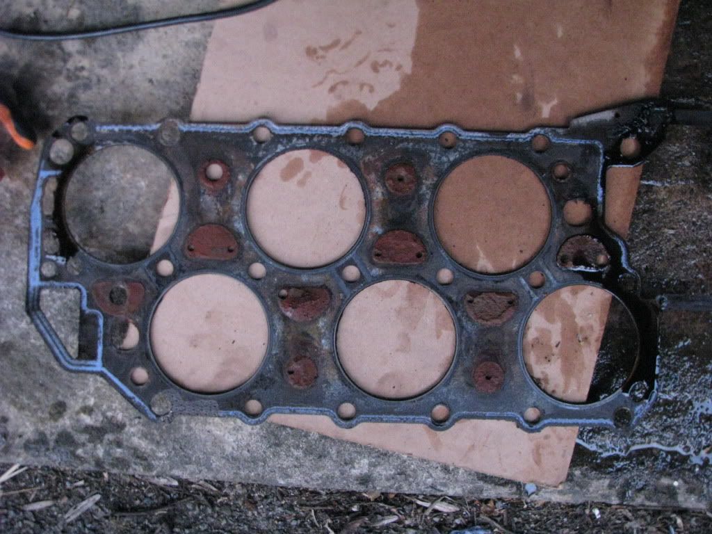

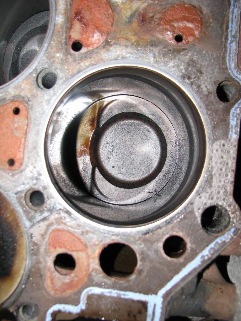

TimDoc 0 Posted June 30, 2011 Here we go - replies on a postcard please! Is that a leaking gasket - cylinders 1 and 6 look manky, but cant see any scoring - would a gasket leak be enough to cause a misfire? If i rebuild - guides will need replacing - i am guessing i might as well do chains at the same time?? Tim Quote Share this post Link to post Share on other sites
Critical_Mass 10 Posted June 30, 2011 1 and 6 look like oil burning to me. They are the first cylinders to suffer from ovalling of the cylinders i believe Quote Share this post Link to post Share on other sites
TimDoc 0 Posted June 30, 2011 how can you check for ovalling without removing the pistons and measuring or is it a diagnosis just made by the fact theres loads of oil, could this just be the gasket having gone at each end or am i just trying to be optimistic? T Quote Share this post Link to post Share on other sites
davidwort 0 Posted June 30, 2011 So was it burning oil then? Could it be valve guides/seals? Was it down on power? I suppose it makes sense to check the block face and head for warping. It doesn't look like an obvious gasket leak from cylinder to cylinder or cylinder to oil gallery. Quote Share this post Link to post Share on other sites
Critical_Mass 10 Posted June 30, 2011 Some one more knowledgable may correct me but, im pretty sure you'd have oil in the water and or steam coming from the exhaust, other then the normal condensation you get when it first starts. Though it could also be the valve stem seals. Hopefully it will be that rather then worn bores. Quote Share this post Link to post Share on other sites

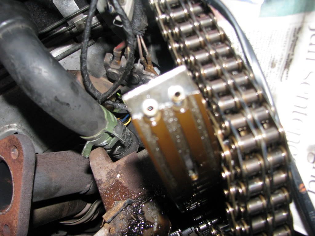

RW1 0 Posted June 30, 2011 No1 is defo busted rings. No.6 on the way out. Wouldn't bother trying to measure, they need doing or...... Vindis offered me a VR6 new half block and pistons for £500 at GTi on Sunday. They took it home. Maybe worth call. Nice busted chain tensioner you got there as well! . Quote Share this post Link to post Share on other sites
fla 9 Posted June 30, 2011 i would change that top chain guide while you're there, looks like the top has worn down totally - unfortunately it means the gearbox has to come off :( EDIT: RW1 beat me to it! Quote Share this post Link to post Share on other sites
TimDoc 0 Posted June 30, 2011 thinking replacement engine will be quicker than all this work, one advertised on 52000 on fleabay - need to check the milage on it. Might look around for a newer one T Quote Share this post Link to post Share on other sites
