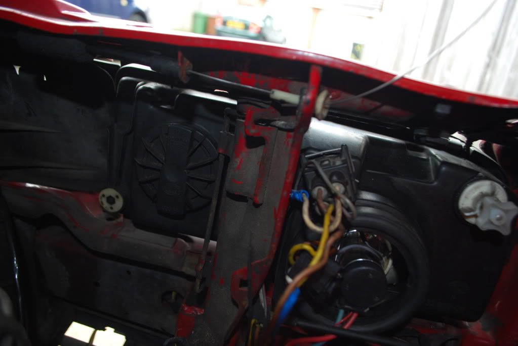

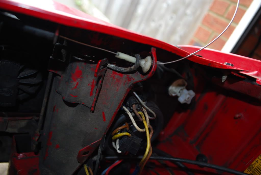

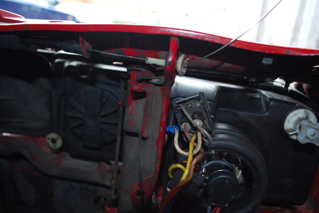

t700bes 1 Posted August 12, 2011 Right, I managed to get the bonnet open I was pushing it towards the wing!!!! I don't understand how it works, or why its not working though.. I'll let the pics do the talking... When I pull on the release cable only the passenger bonnet pin opens... Quote Share this post Link to post Share on other sites
Jim Bowen 1 Posted August 12, 2011 looks ok, when mine broke once i found i just needed to tighten the cable using the brass cone thing at the other end. i think the plastic cone you have there should have the outer black part of cable touching it. Quote Share this post Link to post Share on other sites
KIPVW 0 Posted August 12, 2011 Do you have the cone things the wrong way round? looks olike there is too much slack in the wire, so you need to loosen the small grub bolt on the very end cone piece and pull the wire through more then re-tighten. In the pics is the cone thing plastic or metal? and does it have the grub bolt attached???? Quote Share this post Link to post Share on other sites
t700bes 1 Posted August 12, 2011 I got it working, its slack because the end that goes into the cockpit was on the floor in my attempt to open it, It seems you have to pull it at a certain angle to pop it open.. This is why when I was pulling from undernear it wasn't happening. So all in all, it was just the level that had gone, the cable and parts are all ok! So I have re-threaded the wire through to the cock pit and for now, using molegrips to open the bonnet by pulling on the wire until i work out a solution for the lever! Thanks for you help though guys! Quote Share this post Link to post Share on other sites
