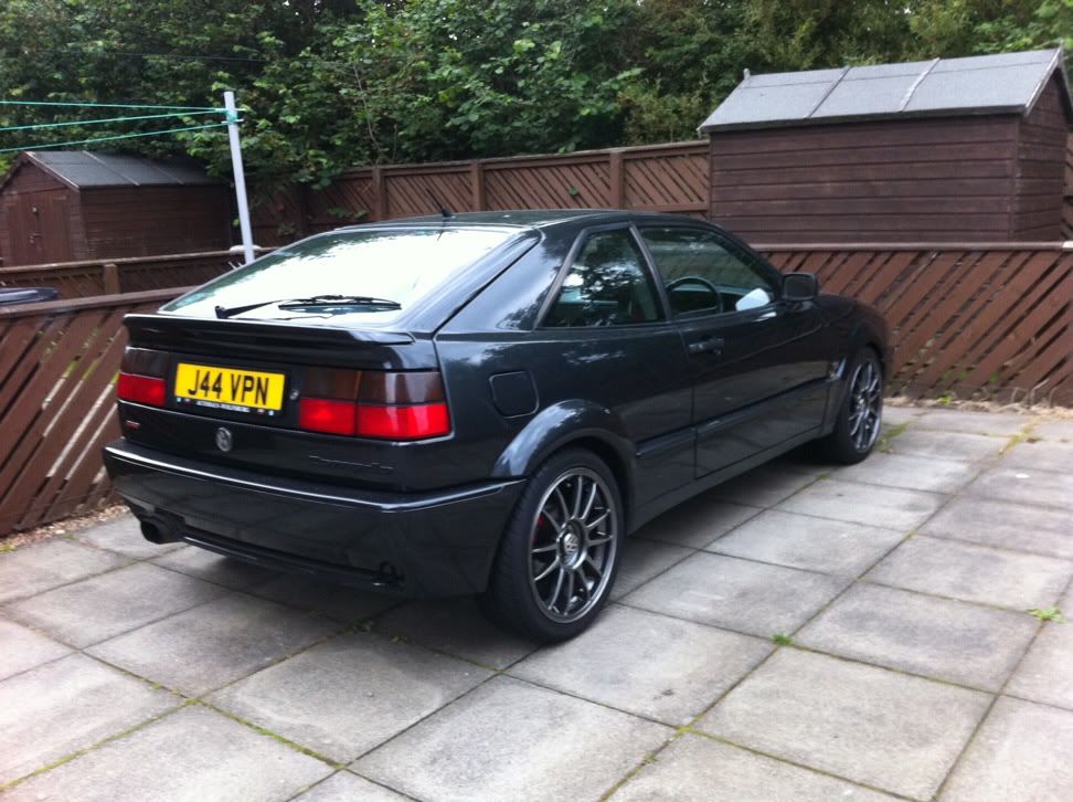

well the alloys are superlegga lightweight ones, in good condition with good tread on them, 17" will be looking for a change, maybe a swap with someone? really like 5 spoke type alloys, azev's etc
probably after xmas may look at doing some engine/charger work. How low can you really go on coilovers with 17' wheels on? think it could little lower than its sitting just now
You'd be welcome to mine if you like them :) Tyres are 215/40/17s - two brand new (~50 miles - 8mm tread) and two part-worn with 5.5mm.
Mine's as low as you'd really want to go (if not lower!) - lovely on the motorway but incredibly uncomfortable over speed bumps and the tyres rub at full lock. I didn't drop it myself but I'd be surprised if it was less than 70mm... When the rest of my parts arrive it's going onto some new coilovers so I can raise it back up again, the roads around here are shocking, and the low-profile tyres don't help...
Stone
no thanks mate, dont like that style of 5 spoke with the groove down middle, im thinking about getting these
[ATTACH=CONFIG]49009[/ATTACH]
car was away today to get tracking done, was my gf that took it as im offshore, but she said they couldnt do it as something on drivers side wouldnt let loose, they tried heating it up to no effect, now i dont fully know what she means but thats what she is telling me, is it probably the wheel on to tight? or what other piece of car would be used to do for tracking
Not sure yet what style to go for, but i will definately be changing them over
