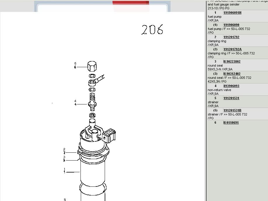

owen g60 10 Posted October 1, 2011 all the parts you may need should be listed on this image... just select the ones correct for your engine code Quote Share this post Link to post Share on other sites
guildmage 11 Posted October 1, 2011 thanks :) that will keep me busy Quote Share this post Link to post Share on other sites

guildmage 11 Posted October 9, 2011 According to the picture above my car would need replacement part number: 191 906 091H ... but I am struggling to find such part.. well ebay list following part: click According to description it's a direct replacement for: 191906092, 191906092C, 191906092G, 191906092M, 533906092N, 533906092P, 357906092C but my number 191 906 091H is not listed there. Yet on the item description it says it is "Fuel Pump & Strainer for in Tank VW Corrado 16v", is that mean there are different models of such pump available. I need to get something fairly quickly as my car started to misbehave again - this time almost on full tank. It started to choke-like then engine just died. Tried to start and no effect. Waited maybe 5 mins, and started fine - again could hear the buzzing and car was running but was something obviously not right. Switched off for like 30mins and started again - was able to drive few miles and no buzzing and no choking-like-effects. It really puzzles me. I just need to get that part and get this replaced asap. Quote Share this post Link to post Share on other sites
