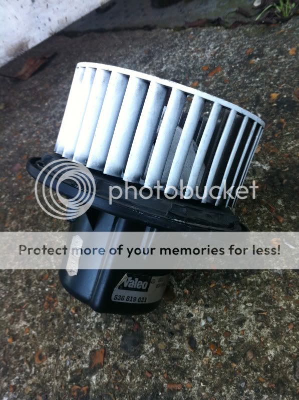

StueyB 0 Posted November 21, 2011 eBay ones tend to be chinese jobbies mate so I would avoid if you plan to keep the car for some time to come. I would imagine the ARZ-Tuning example if as specified (Valeo) will be a genuine supplied item like below: P/N: 536 819 021 Quote Share this post Link to post Share on other sites

Supercharged 2 Posted November 21, 2011 New ones don't come with the resistor pack as it's a MK2 Golf part and that only had 3 spd's. I'd buy genuine if you can, used to be £50 from VW and slightly cheaper from GSF (same Valeo unit) Quote Share this post Link to post Share on other sites
dragon green 5 Posted November 21, 2011 I had an e-bay one,didn't last long before it got noisy ! Bought a genuine one, shifts more air,quieter,buy cheap,buy twice ! Quote Share this post Link to post Share on other sites

Supercharged 2 Posted December 22, 2011 That's the air con one... Not sure of the part number but it starts 192 for RHD ---------- Post added at 01:34 PM ---------- Previous post was at 01:32 PM ---------- Found it - 192959101 Quote Share this post Link to post Share on other sites
