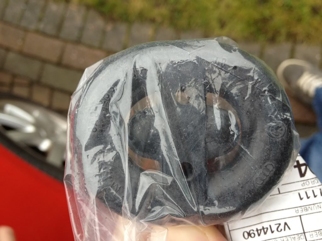

yacobwood 0 Posted January 29, 2012 My rear exhaust rubber has split and VW have given me a completely different looking rubber. Can anybody confirm this will fit or do I have the wrong one? Quote Share this post Link to post Share on other sites
__Andy__ 0 Posted January 29, 2012 thats the wrong one buddy, thats for the early hook type hanger's.. Quote Share this post Link to post Share on other sites
Pat_McCrotch 0 Posted January 29, 2012 The one you need has 1H0 at the start of the PN. Don't quote me but from memory might be 1H0253147B Quote Share this post Link to post Share on other sites

guildmage 11 Posted February 2, 2012 Sorry for hijacking the thread, but I am also in need for such rubber. Is this part number: 1H0253147B correct for 2l 16v 1995. I have "Magnex Cat Back - XSVWC6", but when searched for above part number it is showing slightly different rubber design to mine. Mine looks like that: [ATTACH=CONFIG]51358[/ATTACH] Quote Share this post Link to post Share on other sites

ben_wooduk 0 Posted February 3, 2012 Sorry for hijacking the thread, but I am also in need for such rubber. Is this part number: 1H0253147B correct for 2l 16v 1995. I have "Magnex Cat Back - XSVWC6", but when searched for above part number it is showing slightly different rubber design to mine. Mine looks like that: [ATTACH=CONFIG]51358[/ATTACH] He took his to midland vw in the end but it will be the same, he has a 94 valver with a magnex exhuast. Quote Share this post Link to post Share on other sites
guildmage 11 Posted March 7, 2012 Forgot to report on this one, so doing it now (hopefully it will help someone else too) Part number is: 1H0253147B and in the end I got this part from Midland VW. It was £3.72inc a piece... and this is how it looks new: [ATTACH=CONFIG]54557[/ATTACH] ps. Shame to admit this is still not fitted.. but will make it happen this weekend. I think I need to take some time off work, to accomplish all my plans. Quote Share this post Link to post Share on other sites
